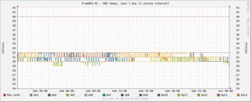

One item I can attest to (in hindsight) is that enterprise grade servers belong in data centers, not in homes, and definitely not in condos where you are space constrained. But if you have to have servers in your home, proper attention must be paid to air flow and sound abatement, otherwise your home just became a datacenter due to the heat and noise.
About the only thing I would do differently would be to install a solid door, to absorb more sound than the current hollow one, but I'm not sure how beneficial that would be as I rely on the gap beneath the door for air inflow, so I can't ever completely seal that room.
One bit I find quite interesting, despite such a sub-optimal installation, and the fact that the closet doesn't get the best airflow (under the door only) ... simply due to creating a system with air flow (i.e. the closet, with defined intake/exhaust) and aligning that with how servers intake and exhaust air, I achieve lower HDD temps in that closet than if a server is sitting in my office horizontally (temporary as I work to solve a fastener issue).
BTW - As a rule of thumb, HDD temps shouldn't exceed 40C (although there are many differing opinions on that).
Server in Office max HDD temp over last 24 hours = 38C
Server in Closet max HDD temp over last 24 hours = 32C
(see attached)
[/end being a ****] :)

Your "upside down" approach is absolutely correct for thermal management, but is difficult, because most systems are not designed to be hung in that orientation, and gravity being what it is, makes computers stood up vertically a little unstable. Still, I like what you've done.
  • Completely understand your point, but between gravity tugging at ~125-150 lbs, that plywood is quite firmly planted in the french cleat.
  • I think the fact that I used two vertical wall mount racks, to emulate the four posts of a traditional rack, and attached the servers to each rack with rails, certainly helped with the stability.
  • But should I need to service the server closest to the wall, it requires removal of the one up front and additionally it is a PITA to "rack" those guys without another pair of hands.
As for the door, a solid door helps a little, but not as much as you might think, as wood conducts sound pretty well. A fire rated door (gypsym filled), or a commercial solid slab door (chip board) might be a little better. One option would be to hang a sheet of MLV behind the door.
  • I'm liking the MLV idea (thanks for the info regarding sound absorption).
The gap under the door should be at least equal in area to the duct size exiting the fan. Your 3/8" gap seems to be an ok minimum to match your fan's CFM, but I think that your fan is undersized for the job. You could also cut the sound some more by adding something to the back of the door and the floor to bend the airflow around a serpentine path.
  • I don't disagree that the fan could be stronger. Throwing some numbers at this ... 3/8" x 30" = 11.25 square inches intake vs. ~12.5 square inches exhaust (4" duct).
  • I've struggled thinking about an intake baffle of some sort, as going that route would definitely lower the sound pressure level, but I would think significantly increase static pressure, and put that fan well out of its league.
  • Each server has 3 main fans pulling air around the HDDs, with each rated at 72.5 CFM @ 1.09 in. H20 static pressure. The ceiling fan is rated at 100 CFM @ 0.10 in. H20 static pressure and 88 CFM @ 0.25 in. H20 static pressure.
But the biggest cause of noise will be because of the heat. Modern computers speed up their fans (greatly increasing the noise) when their temperature gets too hot. Keep them cooler, and they run much quieter.
  • Correct ... I've taken that into my own hands by way of a script which executes once every 60 seconds and adjusts the fan mode to 1 of 4 available (using the most quiet fan mode possible to keep the warmest HDD at 40C or below). The fans are PWM, but unfortunately the duty cycle can't be controlled more precisely with this era motherboard (the succeeding generation can be controlled to increments of 1/64).

  • Recall the bit about the "right side up" chassis being 5.3C warmer than the "upside down" chassis? I think that precisely confirms your point about re-circulation. Not sure of how much is being re-circulated in an "upside down" orientation, but some for sure.
