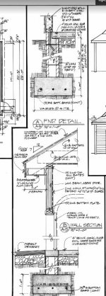

Our new to us house has a 2-car detached. I believe it was built in 1996 when some major addition was done to the house. The left side (viewing from front) sits about 3 feet from a retaining wall below. The front corner mostly, but also this whole side of the garage have settled causing the slab on that half to tilt down on the edges and up in the middle.
Already had the concrete leveling company come out to quote. They suggested doing piers per the attached diagram. Cost is going to be quite up there of course (on the order of $10k).
Does it really seem necessary to do this? Or would it be fine to have a regular concrete company bust up the existing half slab, level with stone and then re-pour? Heck, seems like I could just have the whole floor repoured with insulation underneath, spec'd depth and contraction joints for 2-post lift (likely MaxJax), etc. for significantly less.
It seems like the soil and retaining wall would be fairly well settled after 20 years...

No footers?
I have there original plans for it and footers are spec'd, but of course there are deviations in other (aesthetic) areas...

Is there a toe slope in front of the wall? From what I can tell, it looks like you might have a global stability problem. What is the height of the retaining wall?
Since that is a small block wall (and there is no room for geogrid) the garage foundation should be at or below the bottom elevation of the retaining wall, and the wall should be pinned to the foundation.
The recommendation to install piers is probably the right way to go.

Yeah, you have a issue that will easily be traced back to the type and depth of fill behind the wall, the height of the wall, and the setback of the building from the wall.
Generally, the ideal situation would have the building footing the same distance from the wall as the wall is high (45° from the wall footing).
Drilled-cast piers will get you to the wall footing elevation.
The retaining wall is about 80" high at its tallest. No real toe slope that I can tell.
So is about $8k to put in the piers seem about right? Just a bit of a budget buster for trying to get a smooth level floor. Will have to see where it fits on the priority list.

An 80" tall small block wall needs reinforcement, even standing on its own with no surcharge loading. There is no room for reinforcement there, so it couldn't have been designed or constructed properly. Based on the photos, it looks like everything was built on the side of a hill, and it sure looks like the grade continues to break away from the wall.
Just because it has been in place for 20 years, doesn't mean it isn't going to continue to get worse. It looks as though you could be in danger of serious structural issues in the future, and the problems are far deeper than just an unlevel floor.
