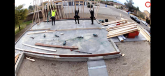

Time to start framing. All in with the lumber and trusses, it was about $13,000 in wood. Quite a bit more than I was planning on in the beginning, but a few months earlier would have cost me twice that, so I was trying to stay positive.
I didn't appreciate how messy the crew was (cigarette butts and food wrapper all over the place), but their quality of work leaves very little to be desired which is the important part.

Here's a closer look at the Simpson panels- a serious amount of steel and glue holding this together. Bolted to my 1" studs buried in concrete.
It was finally time to tear out the wall. They appeared to put the apprentice on this job and he picked every sphere of styrofoam out of the wall so it could blow around my yard. It took forever to clean up when they were done.
It was at this point I made a terrible realization. The whole point of this design was to look like it could have been original to the house- same elevation, pop outs, etc. I started thinking about installing the windows and realized the front windows and garage door would look nothing like the house- they would sit flush with the front of the building while I have recessed doors and windows on the house.
Fortunately it wasn't too late, just more time and money to make it right. The framer suggested adding a wall on the front of the building to give depth for the recesses, but then the eaves wouldn't be right. I came up with a plan to build an inside false wall that would only hold the garage door and drywall up, and the inspected framing would do all the real structural work. I had the concrete guys come back in and pour curbs in place for the wall to go on, and then the framer built onto that. I lose a few square feet, but not a big deal to make it look right.
