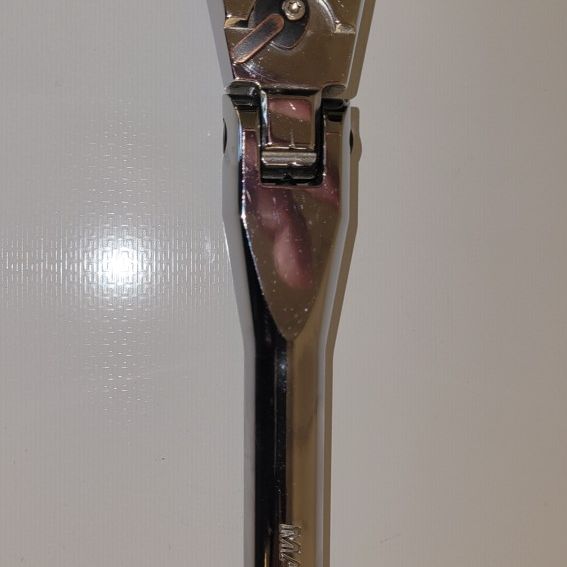

What's the one in the first picture
Toold_up
Feb 9, 2019
640
Attached
My wrench in my Armstrong set is about 11 in.
Seems kinda odd to have a 2 foot one but I guess it's possible.
Ok so technically it's branded Matco, but it was made by Armstrong and their Eliminator series. They also made torque wrenches in the Eliminator series.

This one?
Toold_up
Feb 9, 2019
640
Attached
This one?
Yes but 1/2" drive and 24" flex head.
