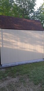

Finally got around to painting the shed
Sherwin Williams colored matched the paint exactly, its spot on the same
Used around 1-3/4 gallons of Sherwin Williams Exterior Super Paint
It's a very thick paint that coated everything very very well
See how it holds up, but I would not hesitate to use this paint again
Total cost with some misc supplies was $105

D
D45
Mar 21, 2014
4,842
NW INDIANA
Hope the pics work
xtremek
Apr 13, 2012
11,603
St. Johns, Mi
The pics came in nice. Now that you've proven yourself to do professional level work, I have about 2500 sqft of buildings that needs painting. Feel free to drop by. I'll even provide food and libations.
