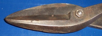

Here is another pair that is different, a pair of Pexto 2A doubel cuts. The jaws are for cutting duck pipe or holes in panels similar to some of the double cut power shears that are sold.
But they also have a crimper for shrinking one end so it will fit into another pipe.
I used the crimper on some round gutter downspout on the shed project. It worked well! it's not as deep a crimp as the ones from the factory, but completely adequate.

I found a set of these at the Estate sale of an old time Tin Knocker for something like $5. Got them home and found that they would not cut very well due to the far left cutting edge being dulled. Not on the center blade, but the side that reads Pexto in your picture. I was wondering if there is any way to rectify this? I see the Pexto name stamped into the side of yours is half on. Makes me wonder if this is how to fix mine by carefully grinding down on a belt sander until I am past the bad spot. Is this how to fix these? My only other thought was to weld along the edge and carefully file the edge back, but I don't know if these were heat treated hence them not being easily repaired. Man I want to use these things so any help is much appreciated.

Outlawmws what is the point of these things? They seem pretty wimpy compared to some of the previous snips. I pretty much bought these just to figure out the point of them. The blades don't even touch and there is a weird spring on the end for some reason. The handles look like normal though

Those do pretty much the same thing as the PEXTO 2A double cuts I posted with similar jaws. MUCH newer, but same point: cutting ducting.
Those are completely out of adjustment. You need to loosen the screw at the opposite end of the screw with the spring, and then adjust the blades with the spring loaded screw (and to a lesser degree, the middle screw), so you get shearing action without binding. This solves the issue Midman914 was asking about on the older pair.

Thanks for the info, they are made by Chas, Klenk from what I can make out (still kinda dirty)
