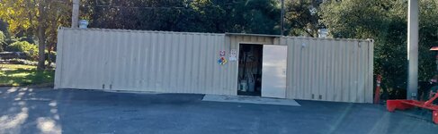

I put a couple in at our shop at work.
The first one we ran underground 120v along with a data conduit for alarm and camera.
two roof top vents
a pre-hung SS door I ordered from Grainger, and used the cut out piece for entry overhead cover.
The second one I added a solar panel for charging a marine AGM battery to run a 12v LED interior lighting setup, along with an exterior dusk to dawn LED in the covered area, pre-hung SS door.
I used 1 solar powered roof vent on this container.
We rarely use the OEM double doors.
I'm surprised in all the years we've had these, we've never had a rodent or spider issue. They are sealed well.
