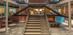

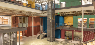

Here is one we installed at work. It is connected to our training room and has a couple small meeting rooms in it. Mostly was added as a way to add something fun to the shop part of the building and a conversation starter.
Nice shop...what lights are you using? They look to be doing a good job.
I don't know the models, they are all LED but the electrician just supplied coverage based on what the architect spec'd for the building. There are more fixtures in the shop area than the warehouse area.
The lights in the warehouse and shop have held up better than what we have in the office though. A number of fixtures in the office have gone bad.
