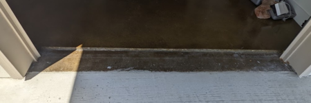

I have a 40x60 shop. It was designed to be completely flat, but with the following considerations:
* Some slope within a few feet of the garage opening or 1" cut out to fit the garage door. A cut out at the garage door really makes a huge difference in getting **** in the garage. Your doors WILL get water on them and as it drains off the door, it's going to try to go "downhill".
* The shop is elevated above site grade, probably 4" after back-filling a slight "swale" all the way around.
* I cannot speak to what your AHJ is going to want, but better to figure it out before pouring concrete..
* I have one "low spot" unfortunately right outside the man door. Which means I get a 1/16th inch puddle there when it rains.. :)
