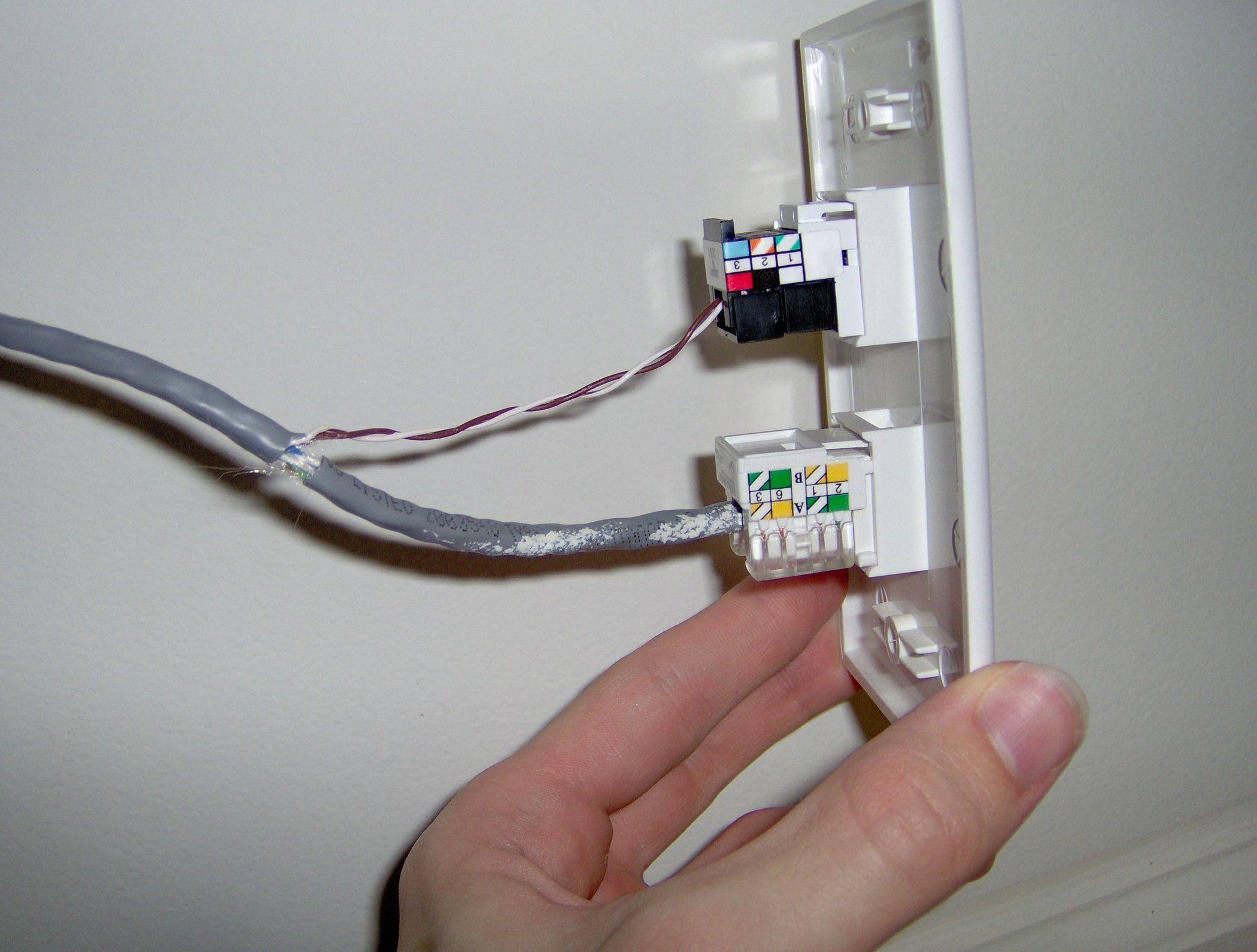

If you have Cat5 or better you can have both a land line and ethernet in the shop.
Ethernet only uses 4 of the 8 wires (two pairs) in a CAT5 cable, your land line runs on 2 wires (one pair)
I built my own Cat6 cables and it was pretty easy to do this, I have both land line and ethernet in my shop that is about 200 feet away from my router.

Post #9 Boring Hop Yard. Give that a look. If you have the extra pairs you’re good. Good chance cat5 was used for the phone. If not, you might be able to pull 1-2 cat5/6 from the house using the phone wire. You can find a used linksys or netgear router for the magical 5 bucks on Craigs, marketplace, goodwill, etc. Look for a vid on YouTube like “how to connect 2 routers on the same wifi”, or find a kid. You will get Wi-Fi plus 3-4 switch ports In the garage.

First, I want to apologize for not responding sooner.
Rooster59 is right on the money.
I ran cat5 in about 100 feet of conduit underground, I did this so I could have a phone in the shop.
I purchase cat5 because it was the latest and greatest at the time of installation.
At first, I started doing research on intercoms so my wife could get a hold of me rather than walking out to the shop.
Then I started thinking I wanted internet and looked at options.
The process can be confusing first time around, the "hack your house" link I shared was the process I followed.
