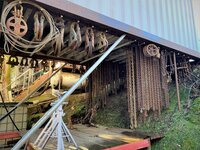

After months and forgetting about this thread, I just got an email notice of activity on this thread.
Not an attachment, but a question. Recently acquired a Clark C500YS80, has side shift but not fork positioning.
Thought I'd inquire here, on the "think outta da box" forklift attachment thread..,,about any sort of clever way of
using the side shift function to also (help) position the forks? They are just heavy enough, that they are a bear to move dry,
but I'd rather not have to keep them and the carriage slathered with grease so they move easy.
So far, I have "piece of chain" stuck in my head, that would attach to a slotted bracket on top of each fork,
shift the carriage, fork stays still. The brackets I'm thinking of would have a vertical slot, that any link of the chain could slip into, depending on length needed. Bracket on each fork, and on each side of the carriage.
What say Ye ?

Fortunately, my forks are light enough to easily position but heavier forks do take a lot more effort. I can see your chain idea working dk. I'd probably first try welding bolts on either side of the forks about 6" from the top where the end link of the chain could slide over. On the sides no load interference or problems with the near side anchor hanging up when shifting the far fork. Anchor on top could rock the fork if the bottom didn't slide with the top.
Probably make the outer slotted adjustment out of bar stock that could hinge down from an extension from the carriage frame on a bolt to a stop at horizontal in use and cam over at top to be out of the way when not in use. On your lift those heavy fenders or light cages might make a better fixed point to hinge or slide the anchor arm from. From that perspective a longish bar with a chain hook placed in a pocket on the fender might give you all the leverage you need and be faster than relying on the side shift at all. Just a couple thoughts...I'd try it if I had the need. Ed.

Can you add a series of vertical bars behind the forks to give you a bunch of spots to pry against with a prybar?
Middle of the fork uprights is better, because if you're just moving them from the top they'll often jam.

I like the idea of a bar with holes to pry from. I wouldn't have a problem minimally welding such a bar to the carriage,
and better than any welding on the forks. Using the side shift would be a bit clumsy and involves multiple steps and
can't really see whats going on while moving the lever from the cab, even standing beside it. So prying from the front
is a better idea I think.

Yeah, holes in a bar would work great, and you could put multiple horizontal rows of holes that are offset from each other, so as the fork travels sideways you'll always have a spot to pry from.

Weld a piece of E track between the outside uprights, behind the forks. You'll have a prying point every inch or two that way.

Regarding fork position with side shift. I have a big Hyster that has side shift and I bought hydrauic cylinders to make fork positioners. The issue I have is, the carriage is split by vertical supports. The inner range is OK for pallets but the forks are too fat for many pallets. The outer area is great for machines and heavy lifts.
Anyway, the forks are on bars and weigh about 400 each. If I can get a fork on the ground with the bar loose, I can use the side shift to move the fork. Not sure about a fork on a rack but, same idea should apply. It is the big one in the pic!
