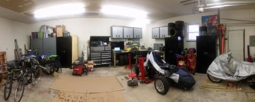

Background:
Moved in about 5 years ago. Before I moved in, the house had been sitting for about 2.5 years after the owners passed. Having only been employed for only 6 years with limited funds, my budget was $250k and that does not get you much in NJ, near Philadelphia. The detached garage which I now call my “shop” was not on the listing, so I was very happy to see it when I arrived for a walk through, I put the offer in the same evening.
The shop is a 30x28 frame, 10ft ceilings, built in 1985. I honestly hate the layout with the tiny 8' wide doors but that's what I have. For all the available space, they could have built a 40x40 or 40x50. If you park a car on the side bays, you cannot swing the doors open all the way, if I put cabinets along side walls. I now have ideas for my next shop.
Anyway, I bought a scissor lift about 2 years ago. The purchase of this lift and the hassle of only being able to use it at 1/2 lift height at 10' ceiling height and prior rainwater damage eventually led to the my Shop Makeover.

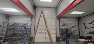

Truss Modification:
Disclaimer: I am not a structural engineer.
The shop had Fink type trusses. There were a few ways to modify the trusses, including this one:
I eventually decided to put in 2 steel beams front to rear. I don’t have a stamped drawing, but the calculations were done by 3 engineers. I ran it by 2 PE friends who were clueless on how to go about this because they have only worked on bridge projects. According to the calculations, the roof live load came out to be ~40 psf (code for where I live is 25 psf) while lifting a 4,000 lbs load in the center. The beams are W12 x 19# x 25' 11” and the posts are hidden inside the walls which are 3 X 3 X 1/4 SQ TUBE 10' .250 WALL sitting on 3/8” x 6 x 8 steel plates which are anchored to the cinder blocks. I lifted the beams in place with a manual hoist. They were notched at the ends to fit under the header and boxed to provide more strength.

This is my first time framing a ceiling and walls. I used strings and 10' levels to align everything. I tied the remaining bottom chord to the beams with Spax Screws and tied the upper framing with 5/16-18 X 5" Carriage bolts and wood glue. I left the 3 trusses as-is in the back side for attic access. The hood of trucks and cars clear the lower part of the ceiling with the lift at the hightest position. I can fit a Ford Crewcab, 8ft bed truck inside and lift it all the way up (kind of scary looking but I balance the truck with 1,500 lbs jacks so it does not rock on the lift. I still have storage above the side bays but I will hardly store anything up there..
I calculated about $1100 for the new insulation on the ceiling and some parts of the open walls. Mice have eaten a good portion of it over the 30 years and I think this was the nastiest part of the project with feces falling down on me during the demo. I had to wear more protection than just a mask and glasses. Browsing FB Marketplace one day, I ran into a contractor’s post who was removing R19 fiber glass insulation from a gym ceiling. I scored a 6x12 trailer packed full of insulation for free. Another guy took 3x as much for his new shop. Worst part was that insulation took about a full bay space as I finished framing. I double stacked most of the attic space achieving somewhere around R30 and had enough left over to lay over the attic in the house..so much insulation! Doing all this during hot and humid days of NJ summer is something I do not recommend doing. It might be my first and last insulation project at this scale.
When i was framing the "pocket" in the mid bay, I did not think ahead of sheetrocking the new walls and went to 50” above the beams for the opening. I could have gone 2” less and just line up the 4x8 sheetrock easily without having to cut & spackle 2 pieces…oh well. I put one sheetrock up myself which took about 40 minutes with a harborfreight sheetrock lift that only goes up ~12'. After that one piece, I cursed, re-evaluated the cost vs time and went onto FB marketplace again to look for contractors. I got a $1100 labor only quote to hang&spackle new and skimcoat existing walls which was a smoking deal. They took 3 days to finish the job.

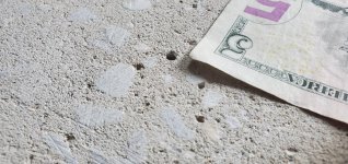

Since this is a DIY heavy product on GarageJournal, I do wish that for DIY people there were more cautions and instructions available on prep. There really is not much media available. I obtained most of the info from here.
My concrete condition was extremely poor. I have thousands of pinholes throughout which I did not quite realize until after the first coat went down. I had used 2 part bondo to cover all the larger holes. After I applied the first thin coat, I tried to fill the small pinholes with pressing a little harder but that did not help. Although not recommended, I should have went over the whole floor to fill in all the holes but may have needed to sand it all again. In total I applied 4 color coats and 2 clear coats. I started at 4PM in the afternoon and was able to get 2-3 hr of sleep in between coats after the 4th coat and finished the last clear coat around 8AM in the morning. Even though I applied so many coats, I can still see the roller marks even though I lightly rolled the entire 26’ distance after each 3’ wide application. I am OK with the final results but because I could not fill all the pinholes, I am not 100% satisfied.
Additionally, I did my attached garage floor with Hellfire as well but used Rustoleum Flakes after the 1st clear coat.
Hellfire is VERY slippery when wet when the floor is cold even with the anti slip additive. It is less slippery in my attached garage with the flakes.
I should have used the flakes in my shop as well, I could have used only the gray flakes to have a uniform look, it is too late for that.

Putting it to use already. Still need to figure out the cabinet situation.

Interesting solution to gain extra height: turning the single span deep trusses into 3 single span trusses with a raised centre section. And using the steel beams as crane rails is just a bonus. Nice job!
The end result is not unlike our steel factory. Main high roof bay with a gantry crane, with a low roof bay on either side.
J
justnutsandbolts
Jun 9, 2015
58
Hey, i saw your garage before and considered doing it like that.
I had messaged you about your lights too.
I wanted to keep the storage space above the side bays. My span is 30ft side to side so it would have required a lot more work to do it like yours.

Although I accepted the fact that it is a floor, I am realizing that Hellfire was a mistake, it is scratching easily and the fact that my concrete was soft is not helping the cause. Next shop will have PEI5 tile.
I am still trying to figure out cabinetry. I am browsing every local industrial auction to find a set. I sold the NewAge Bold Series ones that I ordered from Costco and don't want to bite the bullet for the Pro series due to insane cost.
The latest addition worth mentioning is the 500w (claimed) LED light outside along with a motion sensor. I had to wire my own motion sensor and even though there were some negative comments, I picked up the RAB Lighting STL360W sensor due to its 1000W capacity. The sensor is currently working awesome and I hope it stays that way. The store sold motion lights like the ones I have on the corners of the shop do not work well when I am backing up a car at night. This sensor has detectors underneath of it for a full 360 degree coverage. As soon as I step a foot outside, they come on as well as when I am walking up from 40-50ft away. It also has bright LED scanner lights that act as a deterrent. I will paint the conduit to try to blend it in. Since this was an afterthought, I did not wire it before sheetrock went up and since this is my "shop" the look does not bother me much.
The LED light is from eBay and there is only a few manufacturers for it. This one was made by Tycolight. On my Kill-a-Watt reader, its output was 386W max.
I also picked up older Hallowell worktables and a 1.25" thick steel table that I am contemplating on fitting in the workspace. The tables are 250lbs each and the steel top table is a whopping 875lbs... I think I will turn that into my welding table and put on better casters to move it outside when I'm welding.
