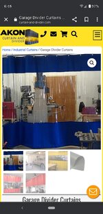

This is what I plan to use. They are made for what you're asking and come in many different configurations.
Sent from my Pixel 3 XL using Tapatalk
