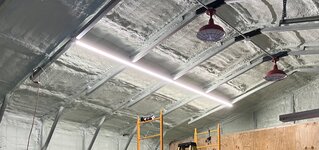

The outlet boxes have all been de-foamed.

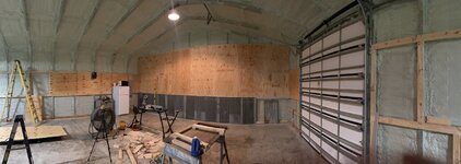

Trying to get plumbing done. Of course I didn’t do a 100% mock up and one section of PEX was a 1/2” short.
Could have finished it if A. had my decoupling tool or B. decided to lengthen the piece I only used clamps on. Option B hit me as I was closing up for the day. Clamps came off easy so….next trip.
Also pressured washed half of the floor in preparation for etch and seal.
