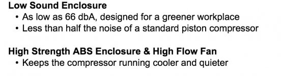

Manuf claims are "... designed for a greener workspace."
I like green and sustainable. But price matters too.
The difference between the two units appears to me to be in the ABS cap on the QE318VE. $900 is a stiff price for a plastic cap with breathing vents.
Is my assessment correct? Price of green, &/or capitalizing on green?

You asked if this thing was just ripping you off because of the "Green" label (odd, since this thread wasn't about green compressors). You need to know what makes it green. If it's "green" because the shroud is made of recycled pop bottles then, yes, you're getting ripped off. Frankly, I think applying the green label to a compressor is BS, but I digress. If there's a well-defined standard for noise to get LEED certification, then the only thing to do is to look it up and find out if the requirements are good enough to satisfy you. Generally, the requirements for LEED certification are not well thought out enough to actually result in a good product, so you do actually need to do your homework and research them.
it is about db. Low db makes it "green." I make no accusation of ripoff. My question is about how the lower db is achieved. The ABS cap? If only the ABS cap then I can make my own.
You can't answer the question.

Bullduck, I agree with Williaty that debating the specifics about the Belaire compressor derails your "show me your compressor DB" survey a bit.
On the other hand, since the Belaire claims to be a "quieted" model, and is one of the few to market an actual DB rating, I can see why you brought it up.

I'd be cautious about that shroud that Belair has got on their compressor. What kind of heat load does that shroud induce?
