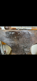

Can you all please let me know what u think about this Peter write Anvil.
Belonged to my wifes grandfather. It was baried under garbage until I pulled it out.
I have heard a lot about 1$ per lb. I would guess that's what a blacksmith would pay for an anvil they entend do give a daily beating.
Is there any collector value in this old chunk of metal? I love it and intend to keep it in my shop for both use and as a piece of history.
I'll give you $1/lb. Where are you at? It is actually worth more like $4/lb today in my area. At least that is what "asking price" would be.
It looks like a good part of the surface may have been resurfaced and is not hardened. The new layer seems to be deforming at least it looks like it in the pictures. Maybe try the ball bearing rebound test on it and see how it does.

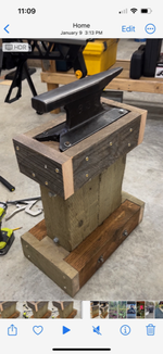

Picked this up two years ago. Paid way too much but supposedly it was a good deal. Peter Wright 176 lbs. I have it on a base now... It came from a government machine shop.
My anvil-paid $125.00 for it. Use it a lot!
A Peter Wright anvil is always a nice addition to a shop. That one looks good. As an aside, do yoi know the proper height for an anvil? Stand beside your anvil, close your fist and swing your fist over the top of the anvil, your fist should just brush the top of anvil with arm held straight.

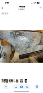

This was my Grandad Charlie Scheuermann's anvil from the Silver Ridge Ranch (cattle and olives; several miles north of Oroville, CA) which he managed from the 1920's into the 1970's. I spent a lot of time there growing up but don't specifically remember him doing horseshoes or implement repairs on it. Shortly before his death, he passed it on to my son Kyle in the later 1980's (he was 3'ish at the time); but Kyle did not survive his 18th year...so I keep it for one of my grandkids to inherit - whichever seems most worthy (you know what I mean). I have only used it occasionally for very light (not hot) work, and other than cleaning and preserving, what you see is what my Granddad saw.
HENRY WRIGHT, ENGLAND, WARRANTED, SOLIL (could be a "D", but it really looks to be an "L") , 53
This is my "new" anvil...1894 or '96'ish I believe:
