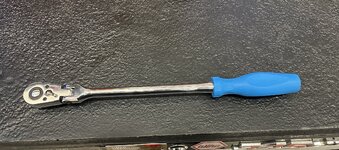

My two modded Pittsburgh 1/4 inchers. I liked the functionality of the swivel head but wasn't fond of the egg shaped handle. The swivel head was just a simple chop with some heatshrink tubing.

Swapped handles on my Tekton swivel heads. Tekton had these hex drivers in their clearance section. I was hoping for red hard handles, but these came out nicely. I know others use the 6 in 1 handles, but I thought that was too big for the 1/4”.
The 3/8 was $5.85, the 5/16 $4.55 and the 1/8 was $3 as it had a blemished blade.
Since I was buying some other things too shipping was free, and as always when buying from Tekton, you get a credit towards your next purchase. - believe 10%.
The 3/8 was actually a perfect fit for the 3/8” drive. It just needed to be drilled deeper. The 1/2” needed a 19/32 drill bit. I forgot to note the one I used for the 1/4”, but I’m pretty sure it was 9/32..
These handles are not as hard as the Snap-On hard handles. I put them in boiling water for ten minutes and still had to drive them off. On the 1/4” I used my normal inverted hard handled screwdriver approach - left a noticeable dent on one wing. A 1x2 did the job without marring the rest.
Putting them on, drove them on 1/2 way and then repeated the boiling water dunk. Pulled them out and finished driving them on.
Disappointed that I messed up on the 1/2” and didn’t get the handle and shaft logos on the same side.
