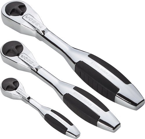

Good review on them from real tool reviews.
I don't want to tell you about the long locking flex versions.lol.
That's a pretty impressive review. The only ratchet I'd be nervous about is the 1/4" drive. That small of a ratchet with 160 teeth is hard to believe.
LXCam
Apr 23, 2013
19,361
G
Tell ya what. I bought that entire set and wish I hadn't. What your boy there fails to address is all the reasons as to why mine go completely unused. First off they weigh a ton, not the end of the world but you certainly know it's in your hand. What does kill it is the back drag is EXCESSIVE beyond belief. I have yet to have myself in a situation where the swing arch was advantageous because of this. The other major problem I have is the rotation selector rotates with the head, so there's nothing intuitive to changing direction while on the bolt. You literally need to remove it and figure out which way to rotate it. Not that it's a mentally challenging obstacle, but it's not something that happens without intentional thought. Maybe one of these days a situation will arise that the strength attributes will come in handy, I've just haven't run into that yet.
My vote is save your money.
gdocktor3
Apr 18, 2015
5,419
Connecticut
Ya I noticed that about the direction selector. Not a fan. I would never buy them either way, but how is the 1/4" ratchet?
LXCam
Apr 23, 2013
19,361
Still brand new. The back drag is so bad it's worthless. And yes, I lubed all of them. And the selector protrusion is so small it's very difficult to switch. My go too's are my GW units.
