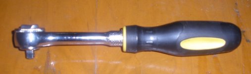

Here's another one.
I didn't bother turning the handle down, I just drilled an undersized "stepped" hole, with two diameters.
Then used a dead blow and hammered it on.
I've been wanting a comfort grip 3/8" ratchet for a while!
The handle is from a Harborfreight screwdriver.

Here's another one.
I would like to do something like that except I plan to use a Duralast screwdriver handle. Hmm...

Can you explain how you did the step drill method?
Sure
It's pretty simple really.
The duralast handle is shaped just like a Snap On handle.
(picture stolen from mrholeshot)
Drill a deep hole the diameter of the single ring of knurling, and then drill a shallower hole a little smaller than the diameter of the double ring of knurling so that the ratchet can get pressed in.
I made the holes very undersized and then just hammered it together.
It seems fairly secure, but if if comes apart I'll just add some epoxy.
