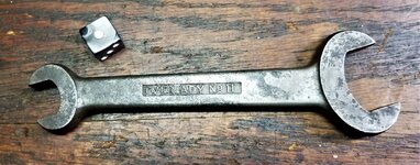

31,039
Despite the branding, I was thinking some kind of tank wrench when I picked this up this morning at the flea.
No other DOE wrench THIS small has openings (1-1/4" x 11/16") THAT big!
But the "EVEREADY" name kept nagging at me for the same reasons that it may be nagging at you. Well, I just figured it out.
This 1922 ad shows that Oxweld Acetylene was using the "EVEREADY" brand on its regulators.
Okay. Good to know. But how and why?
This 1920 article pointing out that Oxweld Acetlyne replaced their "Prest-O-Lite" branding with "Eveready" was also helpful.
But neither one explains how Oxweld Acetlyne was using a brand name associated with batteries since the turn of the century.
Per Wikipedia, in 1914, the American Ever Ready Company (formerly American Novelty and Manufacturing Company) was acquired by National Carbon Company, which merged with Union Carbide to form the Union Carbide and Carbon Company.
Great. But what does that have to do with Oxweld?
The bingo moment was this 1930 article pointing out that Union Carbide and Carbon owned Oxweld Acetylene.
30,058
yes... Eveready = Union Carbide
never knew there was any connection to Oxweld though. could they have gotten the letters in that die any more wonky?
what surprised me was the connection to Prest-O-Lite.
31,039
Me neither! Again, I'm thinking gas all the way, but the name was making me question myself.
I know! The second wrench I have had in a week in which each figure in the dieblock was obviously hand-emplaced.
30,058
There was a reason why both "Oxweld" and "Airco" found places in the list - both of them were directly responsible for a whole bunch of different wrenches. While the connection to Union Carbide shouldn't come as any surprise, I'm still a bit puzzled about the "Prest-O-Lite" connection, although that may well be my having been misinformed in the past about Prest-O-Lite.
The manner in which the letters were set up in the die makes me wonder if that was a one-off run of that particular size, perhaps? (It is, I'm sure you'll agree, an odd duck.)
