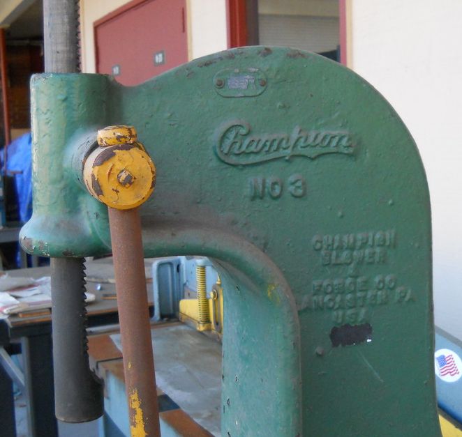

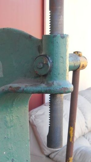

I have been looking locally for an arbor press for a couple of months, mostly finding current HF stuff. I have just come across a Champion #3 made in Lancaster PA by Champion Blower and Forge Company. It's missing its plate and has clearly been outside for a while but isn't especially rusty. I am a bit concerned however that the collar on the arm seems misaligned to the collar on the body. I'd appreciate anyone's opinion as well as thoughts as to what a reasonable price would be.

There might be some serious wear either to the internal bushing or the shaft. either one can be repaired. I'd pay $200 if if I needed it.

While it could be worn, I think it"s more likely core shift, and the hole wasn't bored centered in the boss. Easy to check, and if it is that worn,I"d pass.

Thanks guys for the input.
My concern is that some of the teeth might be missing. Seems like too large a drop just for ware and yet teeth missing shouldn't necessarily equate to any drop at all. Having never had one apart, or even in my hands for that matter, I'm not really sure what to make of it.
Unfortunately it's an 'as is' auction and I won't be able to get my hands on it until the auction is over. Still, I may go for it if I can get it cheap enough. :D
From the other side:
