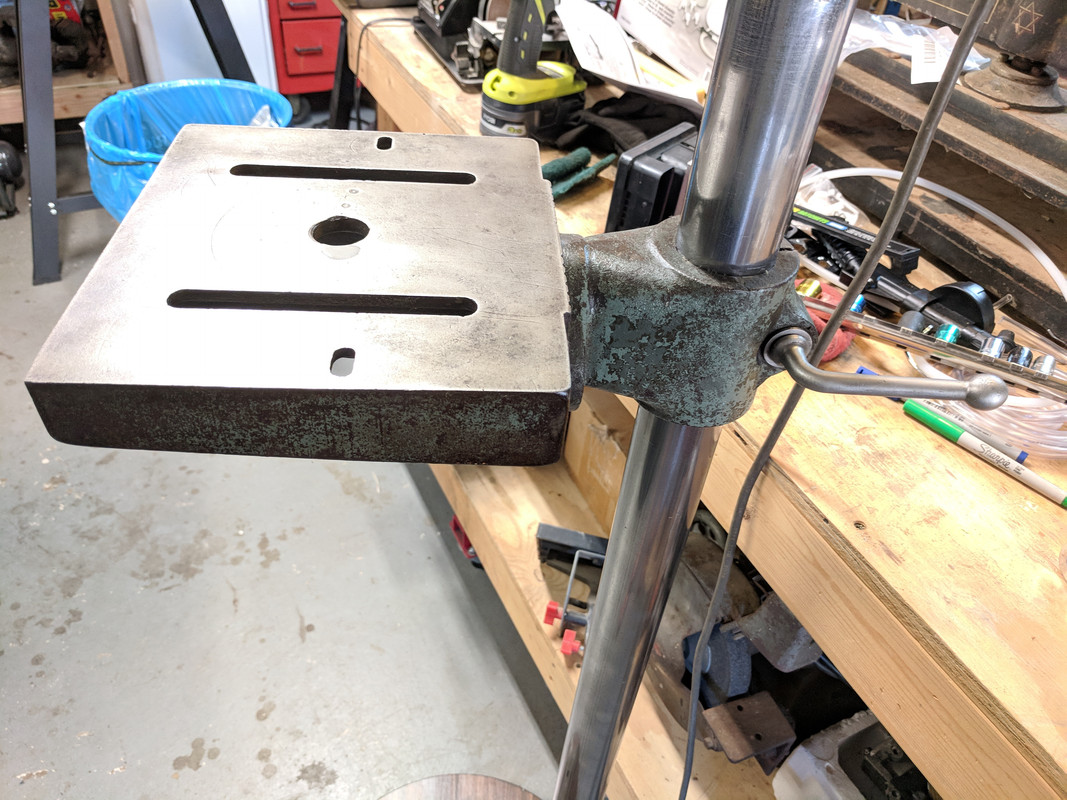

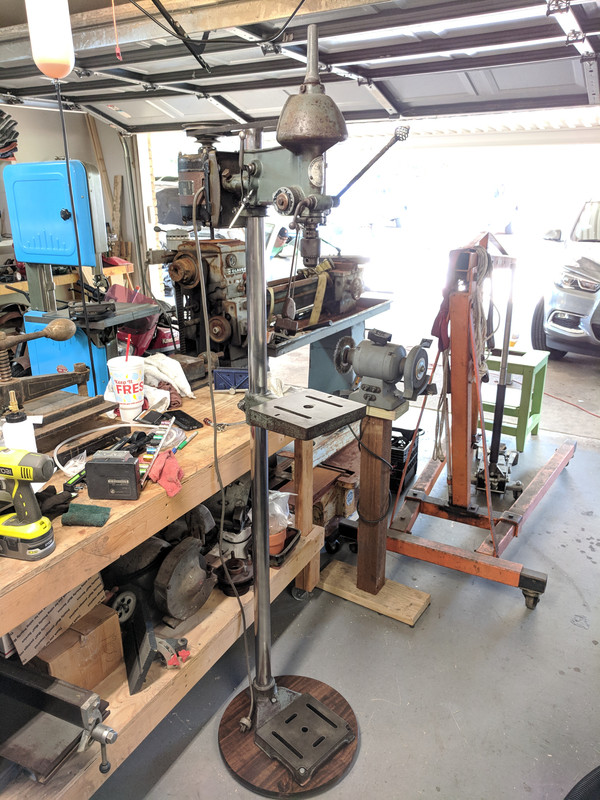

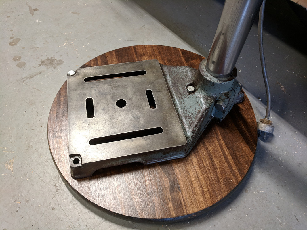

I've got this nice little WT drill press from the 1930's that its my everyday user:
I recently replaced the column with a longer one to make it a standing press. I also added a wider pine bottom to the base to make it steadier. While I had it apart I cleaned it up with some Purple Power and then shined up the table tops, but decided to keep the original finish. I then wiped a light coat of boiled linseed oil on it and let it cook in the sun for a day or so to cure it on. Lookin' good these days!
