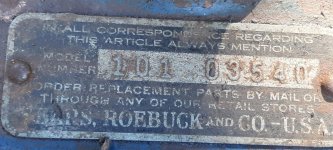

On second look it appears that read C29 not C39 on that pic I posted from vintagemachinery. So does anyone how to date these accurately?

Nice snag ooba. The spindle cap was worth your gas money.
Can't help you out with dating the motor. I only have one Companion motor. It reads " 1. 39 " in the "M" block.
Dating the machine itself is a bit easier, at least to get you in the ballpark. Catalogs are the only thing we have to go on so it's "close" but better than nothing. The oval switch plate appears up to 41. 42 shows a rectangular switch plate (incidentally, when they changed switch plates they also corrected the oddball "up is off" feature that Frank mentioned).
38 and earlier catalog machines have two horizontal slots in the table. Machines after that have "X" pattern slots. Can't tell which your machine has.
The return spring assembly is an indicator as well. Yours, with the ratcheting pawl, was a huge improvement over the earlier style. Unfortunately, the catalogs never show that side of the machine. I don't have access to an uninterrupted sequence of Craftsman or Atlas operator manuals but the 38 manual shows the old style, the 41 shows the new style. So...39, 40 or 41ish for that change.
Last indicator is the logo badge. In the late 30s-early 40s, Sears was badging their heaviest duty machines as "Master Craftsman". Nothing different about the machines, it was just a marketing ploy like the later "Super Duty", "Craftsman Commercial", and "Sears Best". I only have one 15" Atlas (which is what yours is), that doesn't have the "Master Craftsman" badge, just the regular Long C badge. That one came to me with factory gray paint, which leads me to believe it left the factory after we started stomping Nazis.
I'd put your machine around 39-41 or thereabouts. Have fun with it! They're very simple machines with a classic look. I've rebuilt many of them and always enjoy it. I tore apart a 47 King Seeley 100 tonight and I'm on a learning curve. I'm wearing Franks DP thread out and it's very helpful. Thanks Frank!!

Recently, I had two 115.5454 motors pass through my shop. Mine were badged Dunlap though, so I think later than the Companion era, but I dunno. I can't add any further insight to the "M" box deciphering, but mine were K 5 1 and L 2 1.
I also had a Companion S-4390 motor that I believe pre-dated the 115 series. It had a code J 4 7.
I've had several Atlas and Atlas-Craftsman machines and always thought the difference in the spring housing designs was a model line feature. It's good to know now that it was an evolutionary change. My learning curve on Atlas is more like a learning roundabout with no exit.
39,439
Companion predated Dunlap (Then was brought back many years later - at a minimum, a lower grade of wrenches and perhaps limited socket sets. I don't think they were sold individually the way Craftsman were, and I know they had very limited warranties.)
Companion - 33-40
Dunlap 41-60, then tapering sharply off to 63 or 4
JoCoSawdust
Nov 19, 2018
2,416
Eastern NC
Frank, to my knowledge, that ratcheting pawl return spring assembly only showed up on the 15" machines. I've never seen a smaller Atlas DP with that mechanism on it. I've got several of the older style 15 inchers and one of the pawl style. I'll compare model numbers tomorrow but pretty sure they're the same.

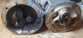

Thank you JoCo, Frank and Outlaw! Im curious to see if this motor can be brought back. Unfortunately I have yet to try to open one up. Advice? I very much would like to bring this press back to nice, running condition, and as original as possible. And for the record the table on mine is an X pattern.

This was a fun restoration.
I'll make one more post below this one for a couple more pictures.
