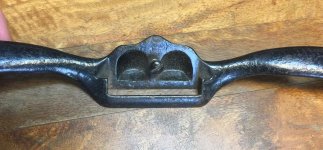

I picked up some handplanes off Craigslist this morning. The Stanley No 95 "edge trimming block plane" is pretty cool and I can see it being useful. Same with the Stanley No 271 router plane. I'm not sure what model the spokeshave is. The seller thought it might be a No 51. There are no markings on the spokeshave except for the "B" on the underside of the handle. The iron is getting short.
Anyone know a site that has info on dating the No 95?
I'd also appreciate any thoughts on which model of spokeshave you guys think this might be.

Thanks RTM. With that catalogue it appears this is a completely unmarked No 51. My other 51 is marked No 51 the back. The handle also has some "texture" on top of the handles. Are you aware of any site where you can possibly date Stanley spokeshaves? I think the other marked No 51 is older than the one I just picked up. Curious is all though. As I've got a No 51 already I'll pass this new one on down the road.

ok, quick notes on the 51 shave.
The blade logo looks like a 1898 - 1902 vintage, but those are easily swapped. The type study focuses on 53 & 54, so not sure about the blade opening. In the study, they are open on top.
There is a hang hole in the one arm, if smaller at the top, same vintage.
There is no checkering, which was added in 1911.
Looking at the back of the cutter cap, is there a letter or numbers stamped?
txlonghorn1989
Feb 27, 2017
2,786
The book puts that as a 1899-1902 trait.
Says Stanley began making the Bailey shaves in 1869, after the buyout.
Do all the features on this spokeshave -"B" stamped on the backside of the cap, "B" stamped on the underside of the handle, Stanley Rule & Level stamped iron and otherwise unmarked - point to it being from this period?

I was able to locate 3 of my No.51 spokeshaves. They are all different from each other in some way.
First shave:
No51 cast into the shave at the rear of the bed
No country name cast into the underside of the handles
Handles are smooth - no knurling
"Stanley Rule and Level" stamped on iron
B is cast under the the cap
Second shave:
"Made in USA" cast under the handle
Handles are knurled
STANLEY Made in USA stamped on iron
No B cast into any part of the shave
Third shave:
No51cast into shave
"Made in Can" on underside of handle
Handles are knurled
STANLEY CANADA stamped on iron
649 stamped under the cap
13,527
Looking at the last two posts, CRS might be right on the tail end of the range I suggested to TX with his first shave. (1898-1902 Type 8) The number cast in to the body was added to the 53 series in 1902. They also say the handle is "solid" here
I can't find anything definitive on the B in the body yet.
Checkering was added to the handles in 1911, and it got a wider, almost spoon profile.
649 under the cap followed B, but in a few different forms. Large seems to go through a wider variety, can't find an age.
Stanley made in USA, does it have the Sweetheart logo? If not, post 1947
Stanley made in Canada ended sometime in the 70s, don't know when it started yet

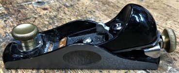

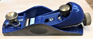

Do any of you have experience with a Record Marples 60 1/2 block plane? It's low angle bevel up and has an adjustable mouth. I bought it new a few years ago. I've fiddled with it in as many ways as I could think of and I cannot get the damned thing to hold a setting. It will produce fine shavings for a stroke or two and then I'll have to advance the blade a little to take a shaving on the third stroke. If the knurled knob is torqued down really tight the plane will cut nicely for 3 or 4 strokes. I think the source of the problem lies in buying it "new". Record and Marples were both highly respected English edge tool makers but they are now owned by Irwin and no longer made in England.
If any of you have suggestions about how this plane could be made to hold a set that doesn't involve the use of Crazy Glue I'll be glad to read them but the issue is moot. I've put a Lie Nielsen on my Christmas wish list.

Hmm, that was my first block plane, bought about 2000. Still my favorite user.
My first question would be how good is the bedding surfaces? Blade to sole, and cap to blade both need to look good and smooth.
Then look at the relation between the screw and the knob and their relative affect on holding. The screw should be tight enough that the cap barely fits under it, use a bit if pressure to seat it. Then tightening the knob should push the front tight, and give you a pressure point in the rear. I can take mine apart if you want pix or measurements of anything.

Thanks for the offer but I've taken mine apart many many times. I'll take your suggestion and check the bedding again. The trouble seems to be with the blade advance screw mechanism. There seems to be an unusual amount of slop. I'll keep fooling with it but for now I want a reliable plane. Do you have another low angle bevel up block plane you'd recommend?
EDIT: I don't remember when I bought mine but it was after 2000 but not by many years. 2007 - 2012 or thereabout.

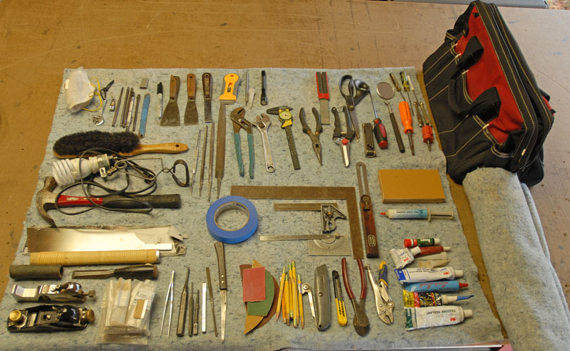

c--my low angle is a bit different, but it is my habit to hold the plane vertically, throat up, with the tensioner backed off so much that the blade rattles loosely in the frame, while shaking it and taking up on the blade adjuster and tightening the tensioner. This takes all the slack out of the system while making the fine adjustment.
My low angle is shown in the foreground of this photo of my portable, general purpose, boat tool kit.

I took mine apart and snapped a pic of the adjuster. The only slop in mine is the little bit of space between where the L bends down, and the widening of the shoulder on the bolt, maybe <1/32".
And I need to retract my previous statements, the screw is not terribly tight on this on, takes several turns of the knob to tighten it down. There are no lumps and bumps under the front edge of the cap, but its not polished or even ground smooth.

RTM and EZ: I followed the suggestions that you gave and I added a few tweaks of my own.
I don't know why I didn't do some of this sooner. I've use this technique when rehabbing many bench planes.
First I checked how well the cutting iron was seated at the plane mouth and found out that it was barely seated at all. I do this by using a permanent marker to ink the area of the mouth that the iron should be in contact with. Then I reassembled the plane and ran the iron in and out a few times. When I disassembled it I could see that the iron was only contacting the mouth a little bit at each edge (see photo 1). Using a very small fine file and a carbide scraper, I lowered the high points, reassembled the plane, and again advanced and retracted the blade. After disassembling the plane (again ) I could tell that there was more contact. I repeated the steps (again) until the iron contacted the mouth for about half the width.
After the mouth, I turned my attention to the other area of the bed with which the iron makes contact (Photo 2). It's the post at the rear and has two parallel contact points. The photo of that area shows that the iron was only touching one. Scrape and dye, scrape and dye got the iron into contact with both parts of the post. CAUTION: The blade advance mechanism sits between the two areas and if the sides are scraped too much it will affect that.
Upon trying the newly tuned block plane on a scrap of cherry that had a small area of wild grain the plane handled beautifully. It took more than a dozen strokes to get down to the bottom of the tear out. The cutting iron held its setting the entire time. I got the same results when I dialed in a heavy shaving.
One problem solved, however, now I can't justify acquiring an expensive new tool. Thanks guys.
Now that I think of it, I don't have a rabbet block plane.

I went to a nearby estate sale and returned with three English planes. A Record No3, a Record No4, and a block plane. I'm not sure of the model number of the block. The last picture is a close-up of a number stamped into the side. There is another number hidden. More on that in a future post.
