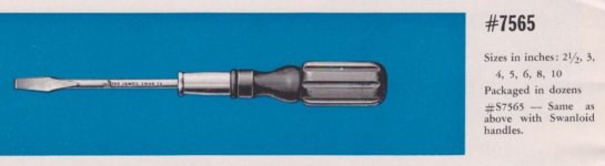

This site...
https://www.davistownmuseum.org/bioSwan.html
has some photo scans they say were taken in "the 1911 James Swan company catalog of "Premium Mechanics' Tools."". In these pics I see a clearer and fresher stamp of the one on my 5/8". However, looking at the 1911 Swan catalog of "Premium Mechanics Tools" posted on Internet Archive shows a catalog with drawings of chisels NOT photos. I did verify inside the 1911 catalog on IA that it IS dated 1911. Not sure I trust those scans from Davis Town Museum.
The 1951 catalog on IA also shows drawings not photos and the logos on those chisels are not like my chisel with "JAS SWAN CO USA". Interesting. I did find some very nice looking "THE JAMES SWAN CO" wooden handle screwdrivers! The #7565 with Swanloid handles! And the #7503 with an interesting handle. Sorry. This is what happens when I see something shiny! :lol_hitti
Have to find more Swan catalog examples. And some of the Swan screwdrivers with Swanloid handles!!!

13,525
The Davistown site has never impressed me with their thoroughness of research on things. I think the Lugzonian is miles ahead, going back to the sources, and using real research. ;).
I saw their pictures when I was looking for Swan references, and knew they weren’t catalog images, since I’d had that catalog open 2 minutes prior.
I’ve got the 1920 catalog on the shelf, if you want to try to close the gap between 1911 and 1951, holler if I can look something up for you
I'd be interested to know just in general if the logo(s) they are showing in that 1920 catalog for their socket chisels match mine with "JAS SWAN CO USA".
13,525
Quick glance says no. The images on the socket chisels show a few different logos, one with a swan to the right of three lines of text, one with it in an oval of text, one with a curved top and flat bottom text. I’ll toss some images here later today.

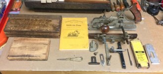

Had the opportunity to pick a small collection of old hand planes and other various tools yesterday. The seller is a general contractor in his 70s who just picked these tools up as he came across them over his career. Decided he wants to downsize a bit. Lucky me. :0) I found some really nice keepers. Keen Kutter K7 jointer plane, Stanley 45 combo plane, Stanley No 0 & No 104 Sweetheart era cherry wood levels, 5 boxes of Stanley combo plane cutters plus one empty box, an early Stanley No 79 side rabbet plane (minus the fence), Stanley No 5-½ plane (Type 11, later lever cap), Stanley Bedrock 605-½ (Type 3), early Stanley No 71 router plane (Type 4), Stanley No 93 1" rabbet plane, Sargent 8" bevel gauge w/ Pat Oct 29 07, Bedrock 603 (Type 6), Bailey No 3 (Type 9), Bailey No 4 (Type 9), Miller Falls No 07B skew plane, Stanley No 64 spokeshave and an unknown model Bailey spokeshave (with a 1858 date?). Both spokeshaves have Sweetheart irons. In the box are parts for the combo plane plus a Stanley Rule & Level Co handbook for their combination planes (1975 reprint), box of Stanley 1-5/8" block plane irons a spare 1-3/8" block plane iron. The seller threw in free a brass No 1 Odd Jobs tool (think it's a remake, Garrett Wade?) and the Miller Falls No 07 skew plane. Not a bad day. Both of the Bedrock planes and the No 4 have been broken down and the rusty parts are soaking in Evaporust.
This is my first Keen Kutter tool. It appears these may have been made by Stanley based on their Bedrock line of planes. Can someone verify that? Also, I'm wondering if the unmarked lever cap would be original or if there was a Keen Kutter marked cap?
Any details on the Bailey spokeshave would be appreciated. I can definitely make out "58" on the underside of the left handle and "Bailey" on the underside of the right handle. There also appears to be more stampings but I cannot read them. Sorry I don't have individual pics of the spokeshaves and the irons are in Evaporust at the moment.
In the last two weeks I've now picked up my first two Miller Falls planes. Excited to have a skew plane. Any info on this skew plane would be appreciate as well. It appears to be missing a screw that keep the side in place.
I suspect the combination plane cutters maybe for a No 55 but I need to investigate. Okay, looks like almost complete boxes 1, 2 and 4 for a No 55. I guess the empty box I bought would have been box # for a No 55. Not sure about the two narrower boxes but they seem to have the same slot as the No 55 cutters. Anyone recognize these two boxes of cutters? Maybe some optional cutters that Stanley sold?
Thanks!

13,525
I think the K series of planes are the equal of Bedrocks, not the KK. These guys from the history books verify that.
https://swingleydev.com/ot/get/53555/thread/
The missing screw from the MF plane should be much easier than the equivalent from a Stanley, as MF was much better about standard thread sizes.
Randy's page will give you all the MF plane info you can handle. The 07 is a rabbet / rebate, the equivalent of the Stanley 140.
http://www.oldtoolheaven.com/bench/bench.htm
http://www.oldtoolheaven.com/blok/blok01.htm
I'll haul out The Spokeshave Book later, but 58 should be a fairly normal one.
I have a non-GW Odd Jobs remake, by SMTC, from the late 1990s (Simpson Machine Tool Co.). Find a manual here
https://archive.org/details/StanleysOddJobs1900
45 manual here
https://archive.org/details/stanleyplaneno45
55 manual here (supposedly "some of the fancy blades won't hit in a 45, but the others are interchangeable")
https://archive.org/details/stanley55planeandhowtouseit1914
More later on the spokeshaves
Thanks!

13,525
Spokeshaves, from the Spokeshave Book by Tom Lamond
The top one, guessing the Stanley 64, lot of catalog cuts in the ITCL.
The bottom looks like a Bailey #1, with a 1858 patent date, but the later version (whatever that means). Should be similar to a Stanley 51, they just added 50 to his model numbers after the acquisition.
Bailey was in many companies over the years 1855 - 1905 (Leonard Bailey will be LB or just B in the following.) moved a lot between RI, MA CT. Supposedly no changes in the catalog cuts for over 40 years. (No tie to the Bailey Tool Co or Selden A Bailey, or Joseph R Bailey of Woonsocket RI. Even those two are not related to each other. very different lever caps, definitely not yours)
LB 1860 - 63
LB & Co 1864 - 65
LB 1866 - 70
B, Woods & Co 1867 - 68
B, Chany & Co 1868 - 69
LB 1870 - 75 (affiliated w Stanley R & L Co
L. Bailey & Co 1876 - 78
B Tool Co 1878 - 79
L. Bailey & Co 1879 - 85 (supposedly no WW tools after sale to Stanley in 1884
https://www.worthpoint.com/worthopedia/spokeshave-book-thomas-lamond-1891666298

txlonghorn1989
Feb 27, 2017
2,786
RTM The Odd Jobs tools does have STMC on it so that's who the maker was.
The MF 07 is actually stamped 07B on the side. Does that help with a made after date?
Here's a pic I didn't post of the box contents. I forgot that there still 3 parts I'm curious about...the screwdriver, the black japanned fence and the little cutter right of the fence. Do any of these look familiar?
And thanks for the links and all the helpful info!

13,525
Let me look harder on the 07b, but most probably later
The fence belongs to a rabbet / rebate like a Stanley 78. There may be a number on it. The shaft should have a weird pitch, like 12-20 if it’s a Stanley. If not a
Odd, might fit another brand.
The blade goes on a wooden molding plane, possibly a small round.
Lugz has IDd that screwdriver I think.

13,525
That 07b is post 1956, when they put the knob on with a visible screw, per old tool heaven.
txlonghorn1989
Feb 27, 2017
2,786
That small cutter appears to be a "special" fluting cutter for a Stanley 45. The hole in the top engages the pin in the adjuster.

I just got plane lucky this weekend. Picked up these two at different places. The bench plane is a Standard Rule #4 size, Standard Rule made planes using Solon Rusts 1883 patent until bought by Stanley about 1891. The compass plane is a Stanley 113, very late, probably WWII vintage.
