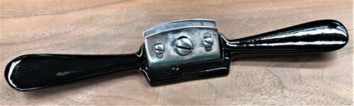

This photo is lifted off a posting in ebay for a Tower and Lyon 24" model. The tote looks really good. He's asking $360 for the plane.
I'm not really familiar with 3-D printing, but I thought the products come out whitish. I don't think paint would stand up very long if you actually used the plane. Might be okay for just a display piece.

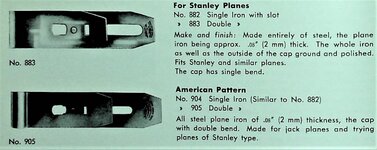

ctuai: What good luck you had finding a plane with a Berg iron! Here's a section of a 1939 Berg catalogue showing what most likely is the iron in your plane. Congrats!

Farmer J: It's looking good. I noticed that the lever was missing but assumed that you had removed it for cleaning.
You should watch YouTubes from Paul Sellers if you haven't already. He has been a professional woodworker for over 50 years and has said many times that a #4 will do almost anything you want it to. He also uses Stanley 151 spokeshaves. He's also a Brit but I don't know if that means anything for this discussion.
By the way, I have re-japanned a spokeshave. Just saying. (Though I do understand your point about being sensitive to chemical odors)
13,537
Dang RT, those look like something Rolex would make! o_O
Some of the new versions of infills can get up in the $5k range, I’m told. Got to play with a Holtey once, was terrified.
