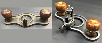

drives: Thanks for routing me to this thread. Speaking of routing, here's The Orphan router plane that I posted on the Woodworking 101 thread. I'll also include some pictures of the Stanley No. 606 I got last week. It's either a late Type 3 or an early Type 4. It has features of each.
NOTE: For those who didn't read the Woodworking 101 post here's a quick recap. I found The Orphan router at a garage sale for $1 and ordered the missing parts from Ebay. I had to buy a 1/4" rod and thread it because no one sells 1/4-24 threaded rod. After the post was drilled and tapped it was just a matter of assembling the parts and making everything shine.

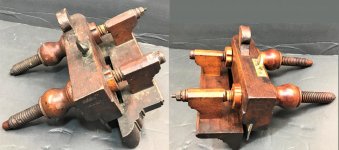

Here is a bronze Cincinnati Tool Co. convex sole spokeshave. In addition, a J. Webb plough plane that was given to me. Now that I have cleaned it, the next step is making new threaded rods for the fence. I've never done that but it looks like an interesting challenge.
That spokeshave is neat! And yes, you're going to have a challenge making new arms for that plow.

crguy: Thanks! For some reason I prefer the English spelling p-l-o-u-g-h when talking about planes. When talking about tractors I use p-l-o-w. If you're interested in how to make threaded dowels to fit an established nut look for Paul Hamler on You Tube. He has specialized in making working miniatures of many different tools. He once made a working 1/2 scale miniature of a Baby Wilton vise and then he made a working 1/3 scale replica of that! Amazing stuff. One or two of his videos are about repairing and reproducing threaded plough plane arms. Oh yeah, look for the video where he talks about making a replica of a presentation plane - out of solid ivory!

Neat old plane though.
more info on mine from cameron.
Hi Mike,
Looks like a Geral No. 1 to me, but probably from a user-made casting. I can't quite remember, but I think all Gerals were marked with the name on one side and the model number on the other side, but there may have been some unmarked planes made by Geral as well. They're not that common, but you do see them on eBay from time to time.
These planes were made for the wheelwright and coachmakers trade. They're essentially a metal version of a coachmaker's T-rabbet plane. They would've cost a lot more than the wooden varieties so that's probably why you don't see a lot of these about.
I can't remember what nationality the company was but I think it's either Canadian or French. I would have to check up n that though.
Regards,
Cameron.
