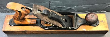

STANLEY BAILEY NO.27 TRANSITIONAL PLANE​
I have wanted to try out a transitional plane for some time so when I found this at an estate sale this morning at a very reasonable price I decided to take the plunge. The patent was for bushings that hold the machine screws of the frog into the wood of the bed. I can only imagine the troubles that machine screws driven directly into wood would have caused.
Note the discrepancy between the patent date stamped into the toe and the one on the patent drawing. Somebody got confused as to which month was the 6th month of the year or they jumped the gun a little.

I love those early transitional planes...so long as I can get them cheap.
I have a little #35(36?) "raisee" smoother that works very well. They're
really great for a traveling tool tote or box. The modern German Ulmia
planes are better (to me)...but oh the cost! Ouch!

A CURIOUS THING: Just to have an idea of what I might be getting into, I watched a You Tube video of a guy "fixing up" a #27. (Don't watch it if you're at all squeamish about doing too much fixing.) I could tell that his #27 was older than mine because the frog was held to the wooden bed with wood screws not machine screws and bushings like mine. The curious thing was that his older plane had STANLEY No.27 stamped into the toe while my newer plane has BAILEY STANLEY RULE AND LEVEL CO. No.27 stamped into it. I know that Bailey and Stanley had an on-again off-again relationship but does anyone have an explanation for the name differences? The iron on mine is stamped STANLEY NEW BRITAIN, CONN. USA
Get a copy of Roger Smith's type study. I will explain the different markings and timeframe.

LATE EDIT: Some gentle cleaning revealed the name B TULLMANN

CRS--Good find. Your scrub looks German. My guess is that Tullermann is an owners stamp.

jimreed: I believe you're correct that B Tullmann is an owner's stamp although the only stamp on the iron is also B TULLMANN.
