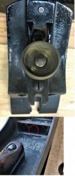

Early Bedrock type 1
This guy arrived in bad shape but it is a rare type 1 Bedrock so I thought it deserved a little cleaning. When they were made in 1898, Stanley used the Baily numbers, so this one is marked "No 5", instead of "605". It has a few nibbles on the side of the toe and the frog is missing its lateral lever. Maybe they both broke in the same nose dive off a bench.
I found some parts to finish it out. It really needs a low knob and a Bedrock type 1 lever cap to make it authentic. But with its damage, it is destined to be a user plane and authenticity is less important. At least it can go back to work.
It doesn't say "Bedrock", it only has a "No.5" on it, and it doesn't have the usual truncated sides. How did you know even know it was a Bedrock model?
jimreed2160
Aug 7, 2016
3,589
Tallahassee FL
Thanks for your interest. I love to rattle on incessantly about Stanley plane minutia. For the Bedrock stuff, I like Bob Kaune's website.
https://www.antique-used-tools.com/brtypes.htm
When Stanley first introduced the Bedrock series, they wanted to offer a premium line of planes that were a cut above in fit and finish with superior user characteristics. The user improvements were all about the frog. Metallic bench planes at the time were similar to the Bailey where the frog sat on the base with contact being a few points of machining. These frogs were adjustable but were prone to being slightly out of square unless the user was very careful. The Bedrocks were fully machined with a flat bottom on the frog and a flat surface on the bed. Once you see the Bedrock frog seating, you can recognize it immediately.
Just as the first Bailey plane soles were not numbered, the first Bedrock soles used Bailey numbers. By the time Bedrock type 2a rolled around in 1899, the Bedrocks soles were marked with the familiar "60x" series. As for the flat sides, they first appeared in 1911 on type 5 Bedrocks.
Knowing these little known factoids can help during purchase time. I have picked up bargains in early Bailey planes because they do not have the familiar marks. Ditto with round side Bedrocks. The only marking on the early ones was the "Bedrock" lever cap. But I have seen many round sided Bedrocks without lever caps and they go for a song.
Round side or flat side, the Bedrocks do perform better than Baileys in my experience. They are some of the highest quality planes Stanley made and backlash is almost always less on Bedrocks than on Baileys. And the fully machined frog means that you never have to worry about the frog being a few degrees off center.
Jim, allow me to rephrase Exmaxima1's question...
When you're browsing in a flea market and find a shelf of fifty
common Stanley #5 planes, how can you spot an early Bedrock
model without disassembling the plane?
Exmaxima, while I've never seen an early "no sixty" Bedrock,
I'd guess that JimReed's starting point is the patent date cast
into the bed. If the plane is old enough, he then takes a closer
look at the frog adjusting screw. There may be differences at
the back of the frog you can spot. Then again, maybe you must
disassemble the plane and look at the frog.
jimreed2160
Aug 7, 2016
3,589
Tallahassee FL
My guess is that the type 1 Bedrocks used some of the same Bailey casting forms as a starting point, so the bed numbers will look alike. So one must look for the patent date and the milled out patent date--that is a dead give away. Only Bedrocks have the patent date and the milled out date.

Not all Bedrocks had the milled out space below the '95 patent date.
You are correct. Only type 1 and early type 2s had milled out dates along with the Bailey plane number cast into the bed. Type 2b and subsequent Bedrocks have the Bedrock 60x numbers cast into their beds.
The question was how to tell if a round sided plane marked with a Bailey bench plane number was really a Bailey or an early Bedrock. One way is to remove the frog and examine the seating. Bedrock planes are milled flat on their entire surface. BUT you can look for the patent date with a milled out date underneath. If you find that, then the plane is an early Bedrock.

jimreed: Thanks! I actually had a use for this one on the Project in Progress but didn't have time to tweak the Bartlett's beforehand. Coincidentally, I found another Bartlett's Nosing plane with a smaller radius in an antique shop a few days ago. I didn't buy it because both wedges were missing and the body had some extra holes in it. I might have to go back and get it. I did buy a J Pearce/Chapin-Stephens jointer (see post #352 ). I had never heard of either J Pearce or Bartlett's Ohio Plane and now in a matter of two weeks I have a collection. Go figure.
Bill vonSteuben
May 5, 2018
60
Atlanta, NY 14808
I found this mid 60's Stanley 9 1/2 with a Craftsman crown logo recently. I cleaned it up enough to use and found what I believe to be the factory grind on the blade.
