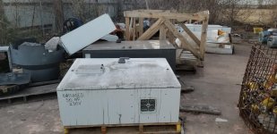

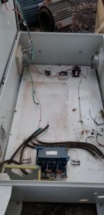

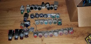

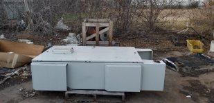

I'm looking at possibly getting these enclosures. I don't know their worth to anyone as shipping would be spendy? There are (2) 3R with doors and (2) without, and the black one is a WEG.
