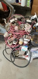

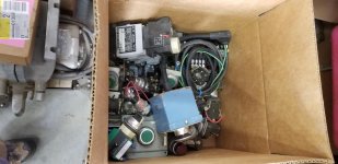

slodat
Feb 6, 2010
3,682
Central-ish, WA
So I'm working on a vfd conversion for a 1.5hp drill press. Already bought a Teco L510 and bench tested it out and all is good. Setting up controls. My question is this: is there a reasonably priced 10k pot that Looks like a common industrial lever switch? Something not so expensive? The cheapest I've found is the $35 dollar one on Factorymation. Is there a cheaper one out there? Is was surprised to not find one on Amazon.
I use Allen Bradley 800T series control components- switches, indicating lamps, etc. They offer a potentiometer. I bought one on eBay. Don’t remember the cost.
Strouty
Mar 21, 2010
38,260
Southern Maine
I have a couple drawers that look just like that box, in fact I think I have a couple of boxes just like that too. Hoarders unite!
