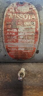

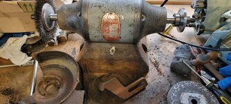

Hello,
Long time lurker, first time posting, so I guess I'm new here!
Here's my Wissota E-7P S found on evilbay, delivered 11/2. My USPS guy got his lifting in, as this is all cast - box weight says 60lbs.
I wouldn't say it was a 'deal', but I 'needed' one and this size is perfect for what I wanted.
Got it out of it's well packaged box, plugged it in - spun right up, but definitely needed bearings from the sound. Took the guards and wheels off. Ran it to polish up the shafts with some random sand paper. Further disassembled with no problems and simple hand tools, knocked the Hoover 77203 bearings out.
A quick trip down to the local bearing place and $20.14 later I had 2 new SKF bearings (Italy made, oh well). Since I had it apart I stripped the paint off the 2 end caps and started thinking about how nice I should make this thing.
I forgot to take some chicken out to defrost, so... had some sardines and went back to reassemble to try it with new bearings. That did the trick! Nice and smooth. So, proceeded to clean up some of the other parts.
Other observations...
Serial Number: 1160
From everything I've seen it appears that the oval shaped tags are earlier, so my guess is this is from 1960?
The base has pretty heavy rusting on the front/sides, but the back and paint is fine.
The paint on this thing appears to be speckled gray with white specks... I thought it was overspray or something, but nope. Thought that was weird.
Missing the RH tool rest, LH rest is a one piece cast part, but is red in color, so not sure if it's from some other machine.
Cast guards have rectangular dust ports.
Need a round cord and bushing.
Missing it's bottom cover, but everything inside the base is clean including the paper tag to wire for 115/230v.
Would love to restore/replace the tag.
Update: angle grinder knotted-rope-cup-of-deathed the paint and crud off the base and guards. I think it's gonna get some rustoleum rustymetalprimer.
Found rubber feet...
Made a bottom cover.
