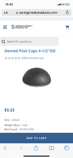

Greetings Everyone,
For those of us rescuing vintage bench grinders that are missing their OEM side covers, here’s a nice method for recreating a respectable looking domed ( for the stone/wire wheel mounting hardware clearance) style side cover(s).
While fabricating a side cover from mild steel plate isn’t too difficult a task, creating that center domed section is a head scratcher.
Spring Creek Products offers weld on round steel ( deep domed, semi domed, and flat) pipe fence caps.
They have the following diameter caps: 1-5/8, 1-7/8, 2-3/8, 2-7/8, 3-1/2, 4-00, 4-1/2, 5-1/2, 6-5/8 and 8-5/8.”
(***4-1/2” cap is 1-1/2” high and approx 12 gauge/ 7/64” thick ***)
They are extremely well priced, and I’m not a paid spokesperson 😎.
There will obviously be some low level fitting/welding skills required but it’s a low buck method for sure…
It beats scrounging eBay for potential candidates or having to drill a big clearance hole for the lock nuts.
Good luck and stay safe!
