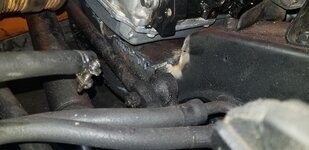

Notched the crossmember on my 1960 Impala to clear the oil pan on the 6.0 LS engine swap underway. Despite getting a Camaro oil pan, which is very shallow up front, the pan rested on the crossmember before the motor mounts hit the perches. Rather than hunt for yet another oil pan, I cut the crossmember saddle front edge and sides, like a box lid flap, with the plasma torch, then took an inch out of the front vertical rise. I banged the "flap" down with a BFH, trimmed the edges and then filled in all gaps with patches.
Not my best work, but certainly functional, and it'll be hidden by the engine anyway. After the last pic, I ground all the welds flat and then sprayed it with undercoating paint.
"A little bit of grinding and a little bit of paint...".[emoji38]bf67ef932f9ce7b9787bacaa6876da90.jpgc9ca5a597ef5a7071b459bea2c188578.jpg2c11dd220ad8e19398d645ee30d4ba88.jpg
