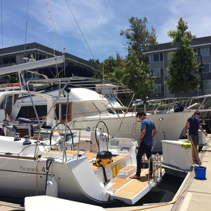

Just recently completed the fabrication and installation of a Bimini frame to support a hardtop, 2 antennas and 4 solar panels on a 45' sailboat. It is 6' high x 14' wide, made of 1-1/4" and 1" polished stainless tube. The boat's original pushpits were reused. The camber and large-radius bends were formed by a specialist subcontractor. My helper and I did all the rest of the bending and fabrication; he did the welding. Fish-mouths were done mostly on the mill.

Nice work!
Gorgeous sailboat!

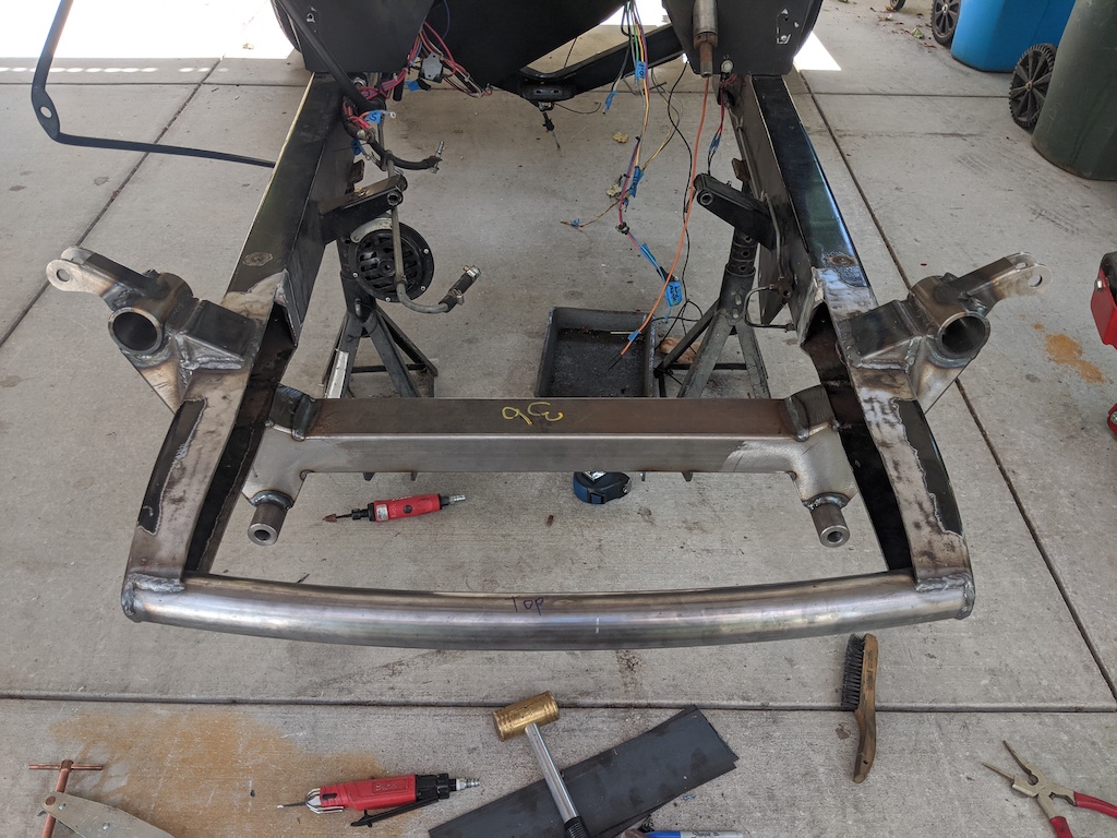

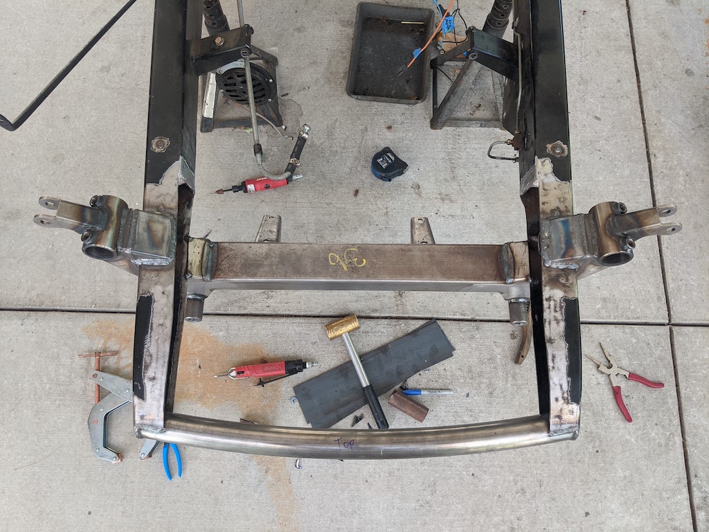

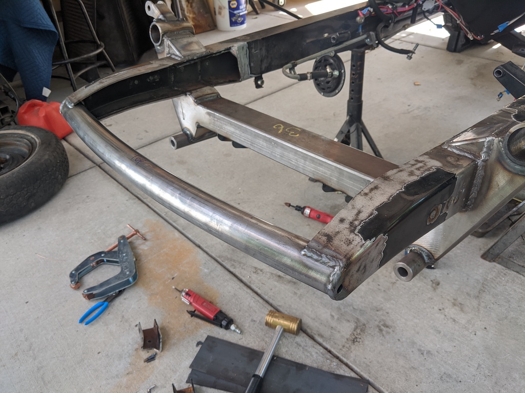

Burned in the front IFS crossmember and rolled tube front bumper for my 33 Chevy this weekend :)
Still need to box the front part of the frame, will probably get to that next weekend.
