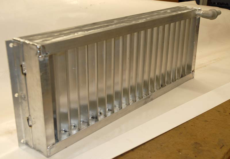

Building a modification to an outboard bracket for my 25' Mako. Re-using the old cast aluminum bracket has been a real PITA! Should have just started from scratch. But it is beginning to take shape. It will support a 250 hp Yamaha 4-stroke plus a small kicker. Additionally it will serve as a swim step and provide a place to secure and stow a telescoping stainless boarding ladder.
Construction is mostly 1/4" 6061 alloy with some 1-1/2" x 1/4" wall tube for the perimeter of the swim step, some 3/4" rod to provide radiused vertical corners on the buoyancy tub, and some 3/8" x 2-1/2" flat bar where it mounts. Attachment is by 5/8-18 stainless allthread through the 2"plus thick transom.
Bottom of tub has been welded. The rest is just tacked together so far.
