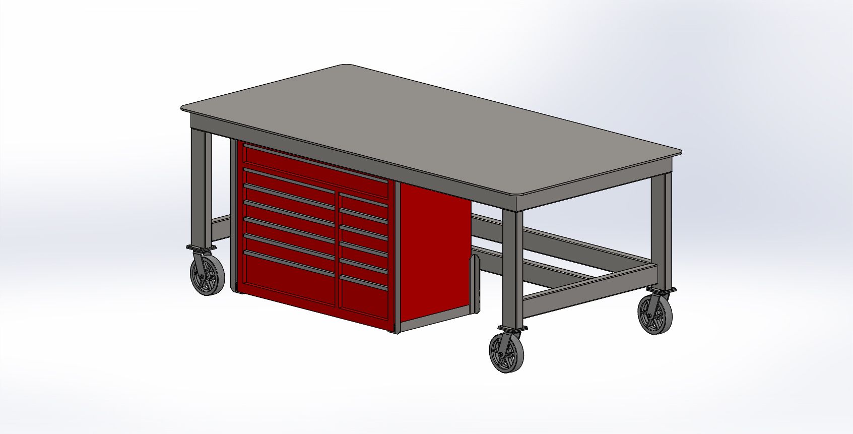

It's in my build thread, so I guess I'm double posting, but it was a fun diversion while I had some holiday down time.
I drew up a chassis table that will double down as a welding table once I'm done building a crawler chassis. I have a 3/8" 4x8 sheet from a bench we scraped at work for the top. I grabbed a 44" HF cabinet on their black Friday sale so I can store all layout and fixturing tools along with specialty grinder and stuff.
I burned some store bought caster plates to the legs so I could get to them in position.
The rest of the frame was fit together upside down.
I used a mag drill to bore some holes through the frame so I could bolt a cradle to hold the cabinet.
The holes were sleeved and then I just fused them in.
I fit the cradle in position and welded it so I wouldn't have to worry about hole alignment. The slop in the sleeved holes helps as well.
My wife painted it.

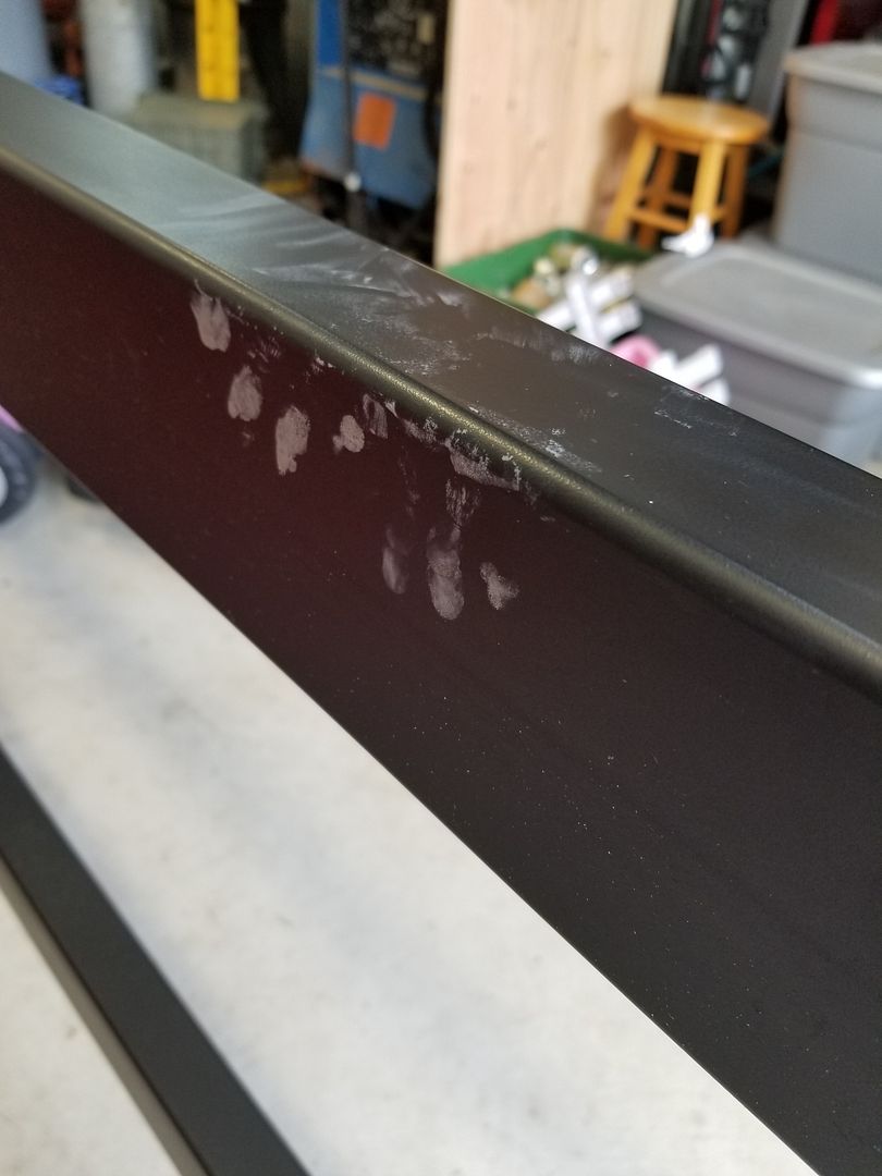

My little kiddo made her mark while I was inside one night and I ended up punching her initials and the date into it before the top went on.
I plotted a coarse pattern and punched a few 5/8" holes with the mag drill.
I cut the fixed jaw off 4 cheap HF F clamps I had and burned on some 5/8 detent pins to make some table clamps. Just an excuse to upgrade to more StrongHands.
Finally I took a burnisher with a interleafed wheel and knocked all the oxide off. I was getting annoying grounding issues through the rust and it looks better for less than an hours work. Glad I had a half respirator though, the dust was coming off thick.
All ready for fixture up a crawler frame.

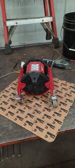

Whipped this up for my new milwaukee led lite. Works great when I'm greasing my truck and trailer 14cecd8acb4e0032fcee09fd755aa77b.jpg

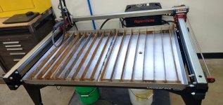

I got rid of my gantry crane since it was a pain to use to load my plasma table. But I still needed a way to lift 100-400lb sheets of steel so I made a Davit crane from a Princess Auto (same as Harbor Freight) pickup truck crane and 440 lb AC winch. The only thing I saved from the truck crane was the hydraulic cylinder and the telescopic boom, The crane is bolted to a reinforced 6” slab4ad0dfdf0a715ae65cc1ea649fd5d544.jpg
Really love your setup there with the crane and sheet storage under the plasma. I had been planning on doing similar sheet storage under my Langmuir Crossfire Pro table, you're the first I've seen to do it. Nice work!
Working out of a 2 car garage every square inch counts and doing this was the best solution I could come up with that's organized by thickness.
That is fantastic, what type of table is that?
Sent from my BE2012 using Tapatalk
It was originally a Wright CNC 4x4 but I cut the table up and expanded it to 4x5 and upgraded to run on linear rails and have a fully welded frame. The only things I saved from the original table were the Z axis system and the X&Y motors and the electronic control box, everything else I built
