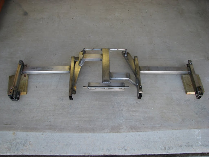

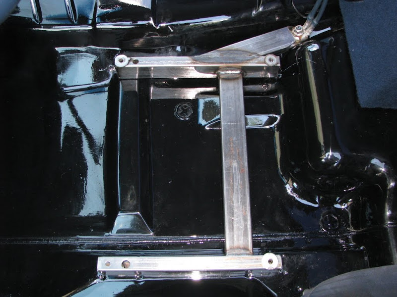

This is a project I did a while back. I found some leather second row seats removed new from a 2010 Odyssey. They had quick release fittings which I took off and replaced with a fabricated seat rail. The cloth bench in my pickup had four mount points, one at each corner, drilling new holes for me is a last resort so I used the existing mount holes and also tied into the seat belt mounts.
The Odyssey seats have integral seat belts on the receptacle side, to compensate for this, I made the seat tracks much beefier than would be necessary to just mount a seat. Because an Odyssey does not have a transmission tunnel the center seat was 7" too tall. I sectioned this out of the seat base and retained the quick release feature of the seat. This made the storage compartment in the seat much smaller but it still folds down to provide an arm rest and cup holders.
Nice. They look comfy.
