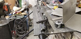

I attempted to buy the Swag Offroad finger brake attachment for my box project, but found it couldn't accomplish what I needed. Decided to try my hand at building a bigger brake out of some extra steel I have. PXL_20241204_143304810.MP.jpg
I didn't have enough big angle iron around, so the top piece is a 2x2 square tube (3/16 wall) that I had from a rack build this year. I had to build a jig to cut it with an Evolution metal circular saw. The other half of it I will use to make Smaller sections to act as fingers. Yes, this was a lot of work, but it's still cheaper than the Baleigh magnetic brake I (still) want.

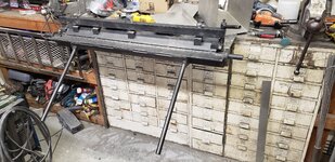

Hey, your brake looks a little like my monstrosity! I made mine to bolt to my 1/2 inch steel workbench table. There are things I would do differently if I did it again but I have bent a ton of stuff on it, super handy. I have a couple smaller finger sections for smaller projects too.

Looks like a nice monstrosity to me! Trying to figure out your clamping methodology, or where mine can improve My use of F clamps to hold the top piece is apparently not good enough. Kept walking on a 10" wide piece of 16 gauge which won't cut it for my target project.

That piece that goes across the top of the angle has nuts welded in for the bolts that get tightened down onto to little pads on the angle to clamp it in place. I always intended to add an arch piece of steel across the top of it because it flexes some when tightening, but it works as is, so haven't done it yet. I could get better pics but I don't know that my design would help you that much.20190811_154150.jpg
