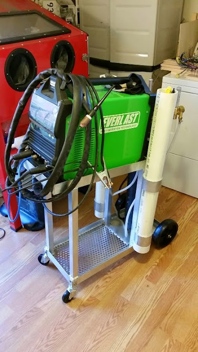

RXtacy
Mar 26, 2015
292
Rockville, MD
Been lurking for a little, first post. There's some really impressive stuff on here. ZTFab your work should be framed man, truly inspiring stuff! I'm getting close to finishing up an all aluminum welding cart.
Just tacked in place.
Added lower plates
Added casters and filler rod holders out of PVC.
Still need to add a middle shelf and bottle retention.
