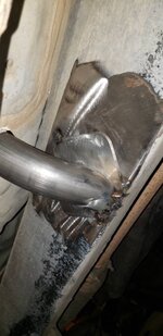

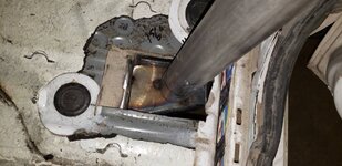

They both look great:thumbup: Like the others definitely interested in seeing you dropper down. Could you maybe show some underside pics of where they'll be attaching to the frame?

So front mount I run a boxed mount off the frame the a pillar lands on. I cut tacks and let it slide down to weld. Notice I dont have any lower portions of the x bracing or dash bar un place so I can drop it down.
B pillar tube bent to hit side of frame where its plated to prevent it ripping the frame.
C pillar lands where old body mount was and has a disc covering hole that is removed to allow it to drop down. Then replaced once back up again.
The bottom of x bracing will land on top of the frame as well to make sure it goes nowhere.
I did my double cab Tacoma this way 2 years ago and it works great
The cage will be tied into the cab sheet metal making everything solid mounted so rear cab mount isnt needed anymore.
