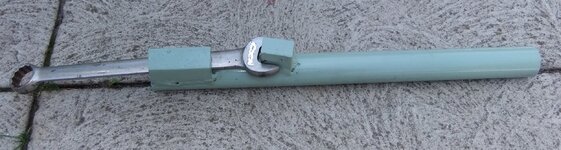

The only wrench extender I've ever used is one of these. Maybe it's tool abuse, or just a redneck adaptation, but I've never had any issues doing it, and I've got more than a hundred wrench extenders just like it.
EDIT: It's an image I found, but looking at it right after I posted it he looks to be using the wrench the opposite of how I would (unless he's about to go counter-clockwise). If he's going clockwise (tightening) I don't see how that's going to work as well for him.
I chewed up the open end of one of my wrenches doing this and I figured it wasn’t a sustainable solution. Plus, it’s not an option for wrenching with the open end. Your mileage may vary, of course
