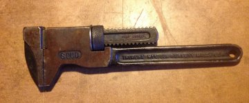

Just an idea if anyone is handy enough to weld a bit they may find a new use for their adjustable wrench
WWIIjeep
May 30, 2012
1,240
Arizona
I agree. The "spud" referred to was the Maddock Spud used on toilets at least as far back as 1915.
How the name was ever applied to an erection/construction/drift wrench, I don't know!
That's not an erection/construction/drift wrench. Certainly it's similar, but it's a Trimo wrench intended for the plumbing trade. Proof, from a 1938 plumbing supply catalog:
Trimont Manufacturing Co. was a major manufacturer of wrenches for the plumbing trade in the late 19th and early 20th centuries.
The subject wrench was intended for use on spud fittings and was based on this particular patent:
http://www.datamp.org/patents/search/advance.php?pn=1613229&id=24928&set=20
There are other types of water closet spuds than just the Maddock type. In addition, some types of sink drains and slip fittings were also called spud fittings--perhaps incorrectly in the original sense, but fact nonetheless.
I know.
What I'm saying is (and I thought you were referring to as well is) that the term "spud wrench" is also often applied to erection/construction/drift wrenches.
Of course, there is also another type of plumbing spud wrench with fixed open jaws, but they are obviously also intended for spud nuts...
Ridgid still markets a spud wrench like the Trimo.

I know.
OK, now we're on the same page. I thought you were calling the plumbing wrench something else.
AFAIK, the spud wrenches used by ironworkers are so-called because one of the several definitions for spud is a pointed bar or lever. That application may be as old as, or older than, the spud fittings used in plumbing.
So the question could also be, how "spud" came to be a name for a plumbing fitting. :headscrat
This is stressing too many brain cells on a Saturday night....:(
spud wrenches for iron workers, or anyone else, allows the wrench to be used as a line up tool.
spud wrench ........... in steam fitting............ special wrench that fits inside and engages a pair of 'ears', 'dogs'. it's the '******' on the right side of the photo. piece is a half union. no way to use an external wrench to tighten that threaded piece into a fitting.
images
using this wrench, of which i have several.
images
