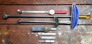

Looking through some of my old stuff I haven't used in decade I found this Indestro 8099, 3/8 torque wrench, only 0-50 pound range. I don't know when or where I got it and am pretty sure I never used it. Just in with other older torque wrenches that I just can't seem to let go (as with most tools). Do not even know how old it is or where I got it. 8099em.jpg
indem1.jpg I don't think I ever bought a Torque Wrench NEW in my life

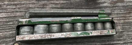

16,674
This Wartime Duro 1/4” drive set arrived in the mail today. All the D-I sockets are there along with the rare crossbar. The ratchets have gotten a little hard to find recently and the spinners have all self destructed. I received the rare 1945 canvas roll recently. I’m missing the G65 and G69 wrenches.

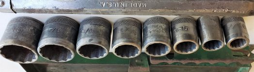

Old Radar
Apr 17, 2019
2,755
San Antonio, TX
Estate sale find for $3.
Indestro 1/2" & 1/4" Hex set missing the screwdriver adapter bit, the 1/4" ell and 5 1/4" sockets.
1/2" Hex sockets include 15/16, 7/8, 3/4, 11/16, 5/8, 9/16, 1/2 and 7/16.
1/4" Hex sockets include 11/32 & 5/16. Missing 1/4, 3/8 & 7/16 Hex; 3/8 round knurled & 1/4 square.
The ratchet head has been pried open a bit and the ratchet gear no longer catches. Don't know if the ratchet failed and they pried it open to try and fix it or by prying it open they broke the ratchet. Forcing the halves closed has little/no effect on the ratcheting mechanism.
The 1/2" socket has been ground down to make it thinner, removing all the exterior identifying features, but he broaching is the same as the other sockets.
The 1958 and early '70 catalogs have this set in a flat "Wall Klip" case enabling it to be fastened to a wall. The 1935 catalog does not have a 1/2" & 1/4" set depicted but has my style of case without the attached 1/4" set. I theorize that sometime between the late 30s and mid-50s, Indestro added the 1/2" & 1/4" combination set that I have and by the mid-50s moved to the Wall Klip case and discontinued this one. Comments?
Note the two different styles and three different stamp sizes on the sockets.

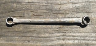

gearhead1960:
Regarding your "open box end wrenches" (as they are called in the catalog):
Those were stamped out by the millions over the course of several decades, with little (or no) change in design.
They're shown in a 1937 Indestro catalog, and they were still appearing in the
1959 catalog. Unfortunately the next catalog I have after 1959 is the 1972 catalog (No. 55), but I'd guess they were still stamping them out well into the 1960s.
Indestro 900 6-pc SAE combination open box end wrench set - 1938 Jensen Byrd Hardware catalog pp.jpg Indestro 900 900-4 900-5 open-box end wrench set - 1937 Indestro catalog pp 10.jpg
Indestro 900-4A 900-4B 900-4C 4-pc SAE combination open box end wrench set - 1948 Indestro catal.jpg Indestro 900-4B 0900-4B 900-4C 0900-4C 900-5A 0900-5A 900-6A 0900-6A open-box end wrench set - 1.jpg

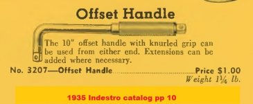

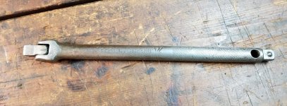

29,774

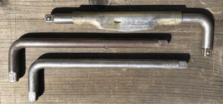

Shelbylex said:
Did they ever make them in 1/4 drive?
I do not recall ever having seen a 1/4" drive "ELL" handle in any Duro-Chrome or Indestro catalogs.
For that matter, I cannot recall ever having seen a 3/8" drive "ELL" handle in any Duro-Chrome or Indestro catalog. I have to defer to d42jeep on that one in regard to the Duro-Chrome line, because he's more familiar with it than I am.
I am finding them in the 1948 Indestro catalog No. 16, but only in 1/2" drive, and only in the "Select" section.
Curiously, both the 1/2' drive "ELL" handles and the "LT" handle are marked as "discontinued" in the 1948 catalog No. 16, but the 646 "LT" handle makes an appearance in the 1959 catalog No. 22.
(Purely wild speculation and conjecture on my part, but my guess is either (a) customer demand or (b) leftover inventory they were still trying to unload. I am leaning toward the latter being the case.)
As to the "swing head handles" (as they are referred to in the Indestro catalog)(aka "breakers"):
I seem to recall a previous discussion somewhere about this. Indestro made the 1/2" drive models available with or without the squared end (with detent ball) at the tail end of the handle - at least in the 1/2" drive.
(I'd have to go dig through a pile of catalogs to determine whether that was the case with 3/8" drive.)
I know for certain that I own specimens of the 1/4" drive 4850 Duro-Chrome swing-head handle withOUT the square end (early production, black finish) and the Indestro 1/4" drive 2850 swing head handle with AND without the square end (early production, black finish), as well as an assortment of later (plated and polished AND cad plated) Indestro 1/4" drive 2850 swing head handles withOUT the square end, but all that stuff is in complete disarray here in this mess.
I can't speculate on any of the 3/8" drive swing head handles other than to say that I do not believe I own any other than the later production plated and polished 2781, which had a round knurled handle with a rounded end.
While the holes at the tail ends of the handles were originally intended to be used with the cross bar (in all drive sizes), Indestro (and Duro Chrome) continued to punch those holes in them right up to the end, even though the cross bars had been discontinued decades prior.
As suggested above, it provided a means to hang them from the display boards, which is what I thought the holes were for until I joined here.
If there were a "Holy Grail" of "ELL" handles, I would submit that it might be the Indestro 3207 1/2" drive "Offset Handle" with the fancy knurled handle.
I have yet to see one anywhere other than in the 1935 catalog.
Shelby, your black-box set above looks like a model 1536. I posted about that set on the previous page.
1948 Indestro catalog pp 29 (crop).jpgIndestro 646 1.2 dr LT handle 1959 Indestro catalog pp 9.jpg
Indestro 3207 1.2 dr offset handle 1935 Indestro catalog pp 10.jpgIndestro 3206 3210 3220 3221 3222 3223 breaker t-handle - 1935 Indestro catalog pp 11.jpg
Indestro 3210 3221 3222 3223 1.2 drive breaker - 1948 Indestro catalog pp 8.jpg

I wonder if additional benefit of continuing the holes at the end of the bar might have a benefit of saving some material (which probably accumulates when you are producing mass quantities). The negative would be the need of QA when they are covered with chrome).

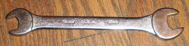

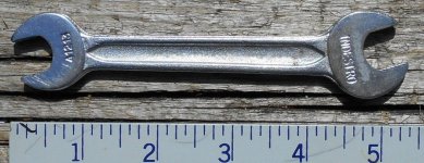

Here's a late production "Duro Indestro" 41213 12mm x 13mm open-end and my 1970 41213 "Indestro" (which turned a LOT of nuts and bolts in the last 50 years) side by side:
Duro Indestro 41213A 12mm x 13mm open end wrench 01 (Ebay 252532614808).jpgDuro Indestro 41213A 12mm x 13mm open end wrench 02 (Ebay 252532614808).jpg
Indestro 41213 12mm x 13mm open end wrench 01.jpgIndestro 41213 12mm x 13mm open end wrench 02.jpg
In fairness, not all of the "Duro-Indestro" product appears to be that crappy. If you peruse through this thread, you'll find photos of late-production "Duro-Indestro" sockets and ratchets I own which are the same top-shelf kind of product as the earlier production stuff.
