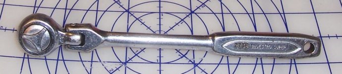

oooo... now that's weird....
that 2775A should not be a flex head. the 3/8" drive flex head was a #2736. (according to both the 1972 catalog 55 and the 1959 catalog 22 - images shown above.)
my guess would be that someone at some point repaired the head with the #2775A-8 repair kit.
(the "A" ratchet had the 6-point "star" selector knob on the back. the #2875, #2775, and #3275 had the 3-point selector knob, as on your #3275 there.)

The flex head 2775A is a nice ratchet. I really like it. Fine tooth, smooth action, and comfortable feel. I feel like I've seen others online? The only brand mark is on the selctor.

a 2736 I've had for several decades. This was my first flex head, and I'm pretty sure my first Indestro. Probably bought at a flea market.

I found this 3/8 flex head ratchet at an estate sale. It has a broken retaining wire. Anyone have any ideas as to where to buy a replacement wire? It seems to be a really nice ratchet and I'd like to put it back in service.
