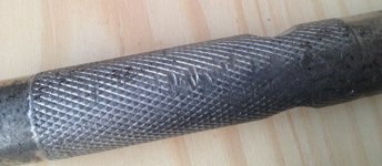

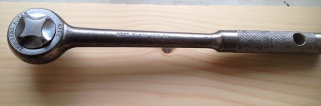

going to add my little collection to here, quite a fan of duro chrome and indestro stuff, after picking up a early 1420 5/8" socket by chance on ebay with some other vintage tools
first a 4472 ratchet, which is so nicely made, real solid heavy feel to it,and pretty smooth working, a few odd 3/8 drive sockets, all the same part number range, but interestingly all different in style and finish, some being G marked war era ones, I would love to find more like the 5/8 one, but not seen any others like that with the plain steel finish, and narrow knurling. [the two small sockets are a little worn sadly]
currently my sole indestro tool, a 13/16th sparkplug socket, still has its original paper sticker, albeit a little worse for wear.
what appears to be full set of ignition wrenches (maybe missing one 1/2" x 7/16ths wrench), in great condition, plus a couple of odd ones and a ring end 2015 3/4 7/8 wrench
Lastly have three of these interesting and very compact ratchets, number 2889, new old stock, a guy on ebay seems to have a small stock of them as he lists them fairly regularly.. no one else seems to bid on them though :headscrat
I'm guessing guessing they are ex MOD stock, sadly i don't have a drive plug for them, and not found a suitable one yet :(
pic of it next to a snap on f70N to show how thin it actually is
hopefully be adding to my collection in time, as i love the sockets and ratchets in partiucular, it is a lot harder to find Duro and particularly indestro over here, some has made it to the UK at some point however, not sure it was ever officioly sold here, so the majority i have got via ebay and the likes....
29,774
Your 2889 1/4" drive ratchet above is the smallest member of this family:
http://www.garagejournal.com/forum/showthread.php?t=36699
You would be doing us a favor if you posted those images in that thread as well.
The Duro Chrome sockets with the cross-hatch knurling are early early stuff -

That's very interesting, as the little ratchet is definitely 3/8"drive, doesnt have a makers name, just made in usa on one side and the part number on other (didn't find much info when i googled it before), will go and post pics on that thread.
Figured the socket may be a really early one, it came with some wright field marked plomb sockets, so possibly made it over here with the US army, will keep looking as its rather nicely made.
Oh and the indestro socket is a 6000 series one, part number is 6248HS
four.cycle said:
The unit does NOT have a patent number or manufacturer's name stamped on it.
It is shown on page 2 of the 1948 Indestro Tool Catalog (No. 16) as a “Midget Reversible Ratchet”. The catalog says it is a 1/4” square female drive, not 3/8” drive.
Well.. that is a bit puzzling, because the catalog shows both the 2888 and 2889 as 1/4" drive ratchets.
The #2889 that I posted the photo of in the other thread was listed on Ebay as a 3/8" drive, as you say yours is.
The 1/4" drive stuff in Indestro Super is all 2800-series numbers. (Indestro Select 1/4" drive would be all 6000-series.)
The 3/8" drive stuff in Indestro Super is all 2700-series numbers. (Indestro Select 3/8" drive would be all 6200-series.)
So... I have no idea... that's a bit strange.

This ones got some cheater pipe or hammer marks on the handle.
I heaved on it pretty good and it works but ill still have the negative reviews I've read here in the back of my mind.
