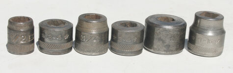

They are all 1/2 hex drive sockets except the top one.
The top one is 1/2 square drive, marked 11/16 with stars on both sides. It is for 11/16 square nuts I believe, either that or some kind of 1/2 square to 11/16 square adapter.
The largest one is a one inch with no markings on the socket, just knurling. also 1/2 hex drive.
16,695
Alloy Artifacts does a decent job on the ID of early Duro and Indestro sockets. The star and trapezoid marked sockets are very likely Duro or Indestro, the rest I’m not sure about. I’m not too strong on hex drive tools.

29,774
^ looks like Duro/Indestro to me.
The 3/4" socket marked " 3/4 " (with no other visible markings) is somewhat puzzling. No stars or trapezoids on that one?

Nothing else on the one marked 3/4.
The knurling width by eyeball looks the same as the 1/2 with the trapezoids but may just be a pretty much standard width for a lot of socket companies.
These were all together in the same box. Along with a 3/8 plug Duro-Chrome 4488 non reversing CUB ratchet.
29,774
Duro/Indestro seemed to be a bit confused about markings - sizes were expressed " 3-4 " and " 3/4 ", some were marked with stars, some were marked with trapezoids.
It might be less confusing if New Britain hadn't been making sockets that looked almost identical.
The "all together in the same box" has to be given some weight - generally speaking, people don't go out of their way to mix up brands of product in tool sets. We can never know what the previous owner may or may not have done, but it's reasonable to assume that everything in the box was the same brand when it was purchased new.
