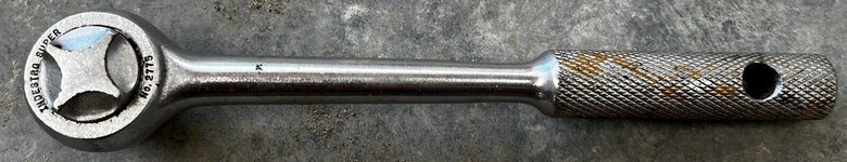

I present to you the original dual pawl ratchet with 80 tooth action, the Duro - Chrome 699 (yeah, it's the same ratchet I posted the other day):
Anyhow I was doing some work and needed a ratchet, I grabbed the 699 because I just cleaned it up and it was sitting on top of my tool box. I'm using it and it seems like one of the finest tooth ratchet I have ever used, seemed odd because it's so old. I counted the teeth by rotating it a 1/4 turn and came up with 20, I was surprised. So I looked over at Alloy Artifacts and here is what I found in part:
Anyhow I though it was very interesting and thought others might as well, the bad news, it's "permanently assembled" meaning if I break it I might as well pitch it.
I discovered this old post. Great info. Thanks Mickey O.
29,774
@The Bean
The ratchet was introduced right after WWII and was produced for only a few years. A 1948 Motor Age magazine advertisement claims they were offering them in 1/4", 3/8" and 1/2" drive, but I believe you'd be hard pressed to find anybody who's seen anything other than the 1/2" drive model.
They were apparently troublesome, and not easily serviceable. The 699D appears in the 1951 catalog (35M) and the 1953 catalog (35).

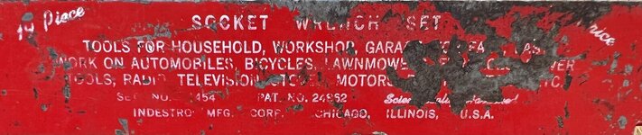

On Thursday, I picked up this handy little box:
Now, most of the stuff isn't Indestro/Duro (the hex socket set is, though) but I could not pass up that label:
A nice listing of everything that goes in the set! But, my question is, are the sockets marked Indestro Select? I know the wrenches are marked Select Steel, but I have never seen a socket marked that, while I have seen some marked Indestro Select.
