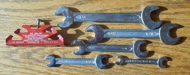

Here is a set of wrenches my wife grabbed for me. Unfortunately, the price sticker pulled off some paint. Bummer
Indestro Bracket 0930-5W and 5 Select Steel Wrenches 5/16 - 3/4".
The holder is design patent D174919, granted June 7, 1955. Not in DATAMP. These look to be a Set no 0930-5W, "same as above except heads unpolished". 5 piece open end wrench set, containing P720, P723, P725B, P27, and P729.
Found them in the 1959 catalog, you can carry them, or wall mount the bracket to hang the wrenches individually, instead of ganged together.
I thought I had another set of these, but don't see them posted in the Indestro thread, guess I gotta go digging for them before I post these there.

I have that same 5-piece SAE open-end set in the "plated and polished" version, 930-5W. (The "0" prefix in front of the part numbers on those sets designates the non-plated variants. Indestro was the Baskin-Robbins of wrench sets - flavors for everybody.)
The wall-bracket-hanger-thingie is genius - worth the price of admission.

13,412
No idea what the schumtz on these might be.... guess I need to get out my can of metal polish? :headscrat
Yours doesn’t have the select steel in the panel. Older or newer than mine? The 59 catalog makes them look blank, guess I need to poke harder into ITCL.

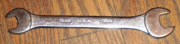

I don't have a picture just yet, and don't want to go to the garage but did any Duro-Chrome wartime ratchets get an OD green paint job? I picked one up this weekend and it doesn't look like a "bubba" spray paint like most of the painted tools I come across. Looks factory.
30,950
Is this socket from a set? Are there more of these in different sizes? Thanks.
Yes and yes. They're in the catalogs, Jim. Check 1940 and 1951. EDIT: Maybe and maybe. There's at least one. There are two different sets separated by many pages. Neither is identified as square or hex. One is clearly square. I though the other was hex, but could also be square and a bad image. Asterisks and footnotes indicate at least one is hex.
What's more unusual is the marking on yours. The full "DURO - INDESTRO" name is uncommon in my experience.
29,774
^ the decline in overall product quality is most noticeable on those open-end wrenches, from what I've seen. I have a set of the newer Duro-Indestro combos, and they're not that much different than the earlier "Super" from the 1970s, but the fit and finish does seem to have really gone to hell in their last days. just my lousy opinion there.
that's odd to see both names on that drain plug socket unless it's a newer item. :headscrat
  • Duro Indestro 41213A 12mm x 13mm open end wrench 01 (Ebay 252532614808).jpg
