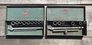

Two different but similar 1/4” drive sets arrived in the mail yesterday. The first has a complete compliment of Duro-Chrome branded sockets with an unmarked flex handle and crossbar. IMG_3615.jpegIMG_3616.jpeg
The second set came with some D-I marked sockets and a Duro marked flex handle and sliding tee. IMG_3617.jpeg
The two sets side by side. Even though the color is similar, one has wrinkle finish and the other is smooth.
I added some D-I sockets to the other set, now it is only missing the 5/16” socket and various drive tools. IMG_0265.jpeg

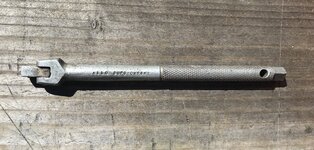

Found some miscellaneous Duro at the flea this morning. The "-D-I-" socket is as humdrum as the uni joint. But that Duro-Chrome 4479 hinge handle might be the first and only 3/8-drive Duro/Indestro drive tool I have ever found in the wild. I'm not sure about the 3/8F-to-1/2M adaptor. Found together, and the finish is right, but the 3-digit P/N ("492") does not look Duro to me. I am happy to use it to demonstrate the female drive opening in the end of the hinge handle, though. :)
39,502
Very nice find on the breaker/extension! I have ONE in the collection for 3/8 also a Duro-Chrome 4479 (kept in the road box)
29,774
^ 492 = 1/2" female x 3/8" male same part number for both Duro and Indestro. was a really good seller because they broke so many of them.
the breaker is odd. I knew they made one with a 3/8" MALE drive anvil on the **** end of the handle, but I don't think I've ever seen one with a FEMALE opening. very odd.

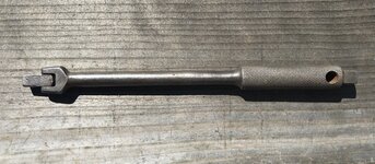

The female pockets were short lived across all brands as the handles were not beefy enough to stick an extension in there to use as a cheater - NOT its intended use - these (that survive) are usually found in 1/2" drive. I can't recall seeing one in 1/4" in any brand? But used as and extension it's a nice feature to have. which is why I put the 3/8 in my road box and would line a couple more if I can ever find them.
I have several in 1/2" drive in a couple of brands.
30,967
Not enough steel. I've thought about squaring off one of the round holes you see in the ends of some of them, put there to sink the detent ball for the crossbar, experimentally, but just holding another hinge handle drive stud against that hole to size it up and you can see how thin the walls would be.

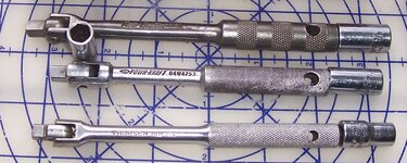

Hmm, Got curious and dug out two 1/4" breakers -
  • The Thorsen 18M is definitely too small.
  • The New Britain NM51 has more than enough!
I'll get comparison pics tomorrow when I have decent Photography light.
Another hack way would be to simply TIG weld a ground short socket to the end...

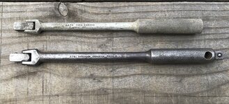

29,774
^ that's a first for me... 2850 was the Indestro number on the 1/4" breaker (Duro number was 4550) ... I wasn't aware there was an Indestro 1/4" version with the male end at the bottom of the handle.
If you are looking for a larger 1/4" breaker HANDLE, the late-production (Triangle) Herbrand should be more than ample enough.

OK, I have daylight assisted photo lighting now and no sales today to distract, and I'm stalling on doing my State taxes... :evil:
I used some Powr-Kraft sockets for size comparisons, and added the Powr-Kraft breaker into the mix:
The New Britain could easily support a drive socket. (3/8 socket for comparison) so could the Powr-Kraft, but slightly smaller (11/32 for comparison -had a hard time aligning but they are the same size). The Thorsen not even close into its stock handle.
Any of them could take a socket TIG welded onto the end, but the Thorsen would have a step, or need a tapered socket for a smoother transition. (The next socket size down in PK did not line up...) the TIG weling method would also give a slightly longer handle. (the NB is the clear winner on that of these three)
I'm not planing on doing this, but it is going into the "If I'm bored" project list that may never get addressed...
I don't remember if I have a 1/4" breaker with the mail tail, but the "refer ratchet" solution is intriguing, but less so for a road box (additional tool - I would want a regular ratchet as well.

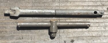

Here's a duro chrome. Seems to work nicely as an extension

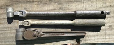

30,967
@Outlawmws When I said I was worried about enough steel, I was referring to the prospect of milling a 1/4-square-drive female opening into the end of a handle, not welding a socket onto the end. When I look at the type of handle provisioned for a crossbar, with the round hole in the end - for access to peen and service the crossbar detent ball, the round hole is very tempting for squaring off. But I worry about enough steel around it. Some pics to illustrate my concern. Most of my 1/4-dr hinge handles have 3/8" diameter knurled handle. A few have 7/16" diameter.

39,502
I get that Lugz, and I agree; many, maybe most, are too small a diameter for this. Heck, some grips are not even round. Thats not an option at all...But a few, like my None Better, could be drilled and broached for it pretty easily. I was just spitballing on the welded "fix" and comparing to sockets, as if the sockets will survive, then the handle should also.
I'd love to find one that was done factory. that would be cool and potentially useful.
I've been working up the idea of a small set of 1/4 drive tools and including a set of 3/8 drive sockets for my inside bench and lantern/stove fettling, and the only reason for 3/8 drive sockets would be for my 3/8 drive in 1/4" ratchets. possibly a 3/8 breaker? This is light work generally

I haven’t seen an Indestro made 1/4” drive breaker with the male square drive either but they definitely made 3/8” drive bars with that feature. These live in my Chrome X Quality set. IMG_3706.jpegIMG_3707.jpeg
This 3/8” drive bar isn’t branded but has a number consistent with Indestro. I keep it with my ratchets. IMG_3708.jpegIMG_3709.jpegIMG_3710.jpeg
